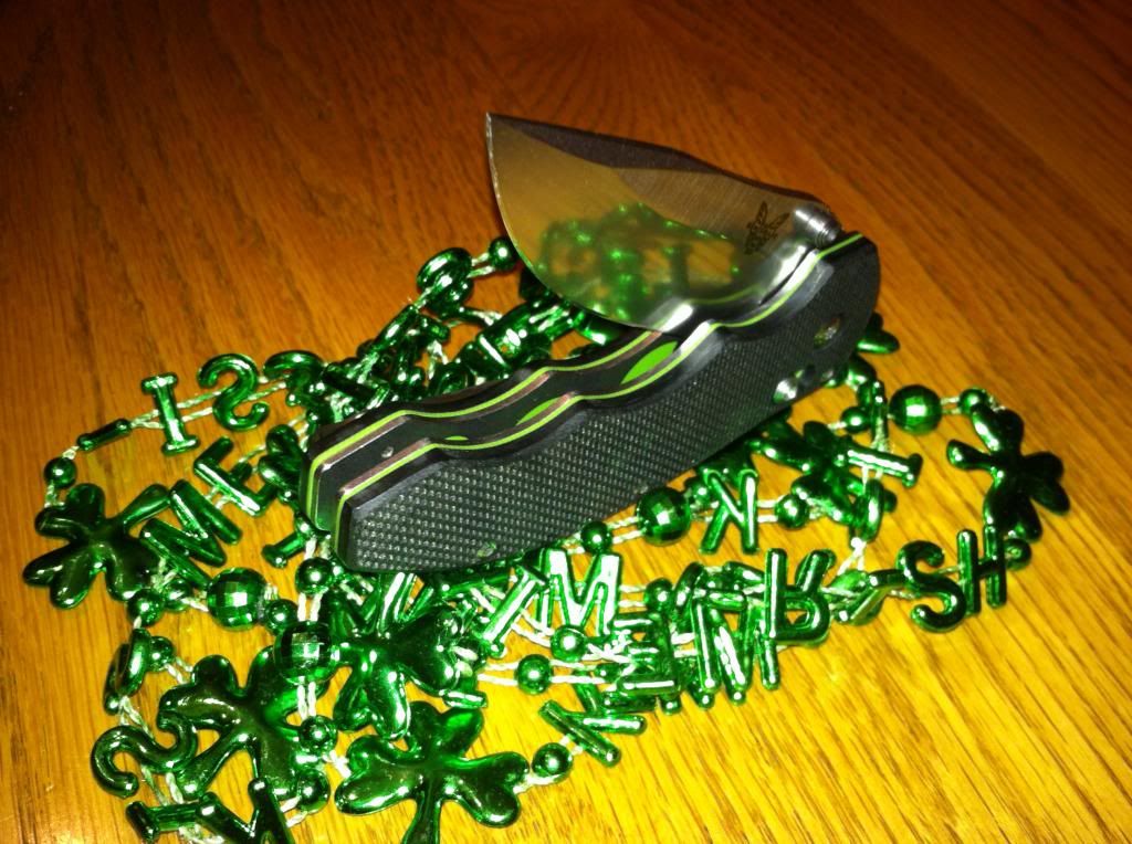

Nice handle Keyman! I have a full size grip i'd like to make them for. I have tiger stripe maple, Brazilian rosewood (which may be too hard) and some very old walnut. Will a belt sander work in place of the table sander? And unfortunately, i have no drill press. What do you use the band saw for, the basic cutting out of the material for scale shape? Do you use the dremel as a router? Sorry i have so many questions.

I use a Dremel in a device that holds it like a mill. I use a structured tooth tungsten carbide cylinder bit to hollow out the area for the omega springs. It works very well every time and holds up awesome to G-10. You can get away with using the Dremel rotary work station if you are good. It's not the best, but it will get the job done for around $40 dollars. Or you can find much better ones online.

I have only used the dremel rotary tool to mill out the back of scales for the omega springs otherwise it is too flimsy for accurate drilling . I use a drill press to drill the counter bores, a band saw to trim the g-10 close, and a sanding drum table to shape the scales to their exact outline. The patterns are done with files or a dremel. A few samples.......
