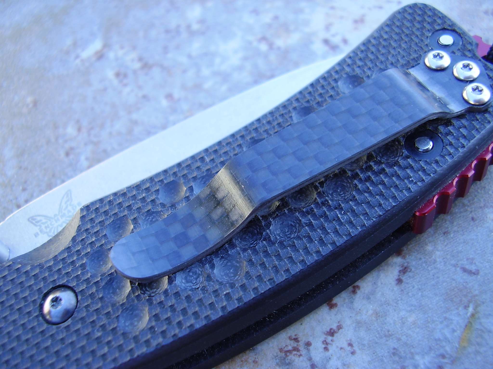

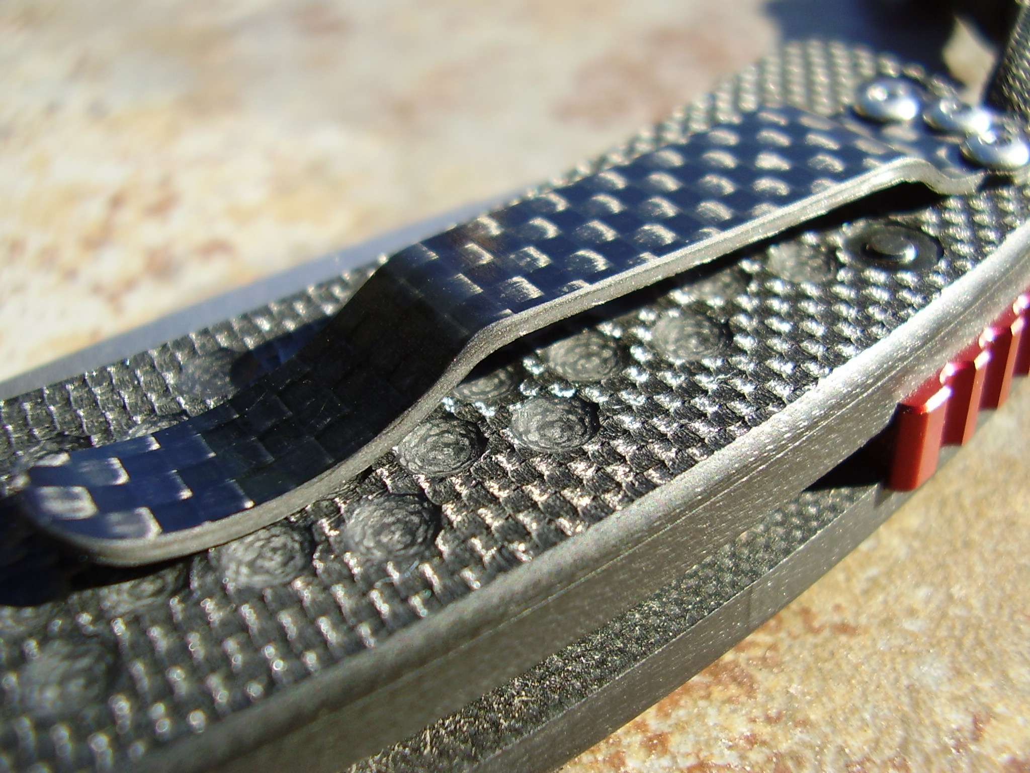

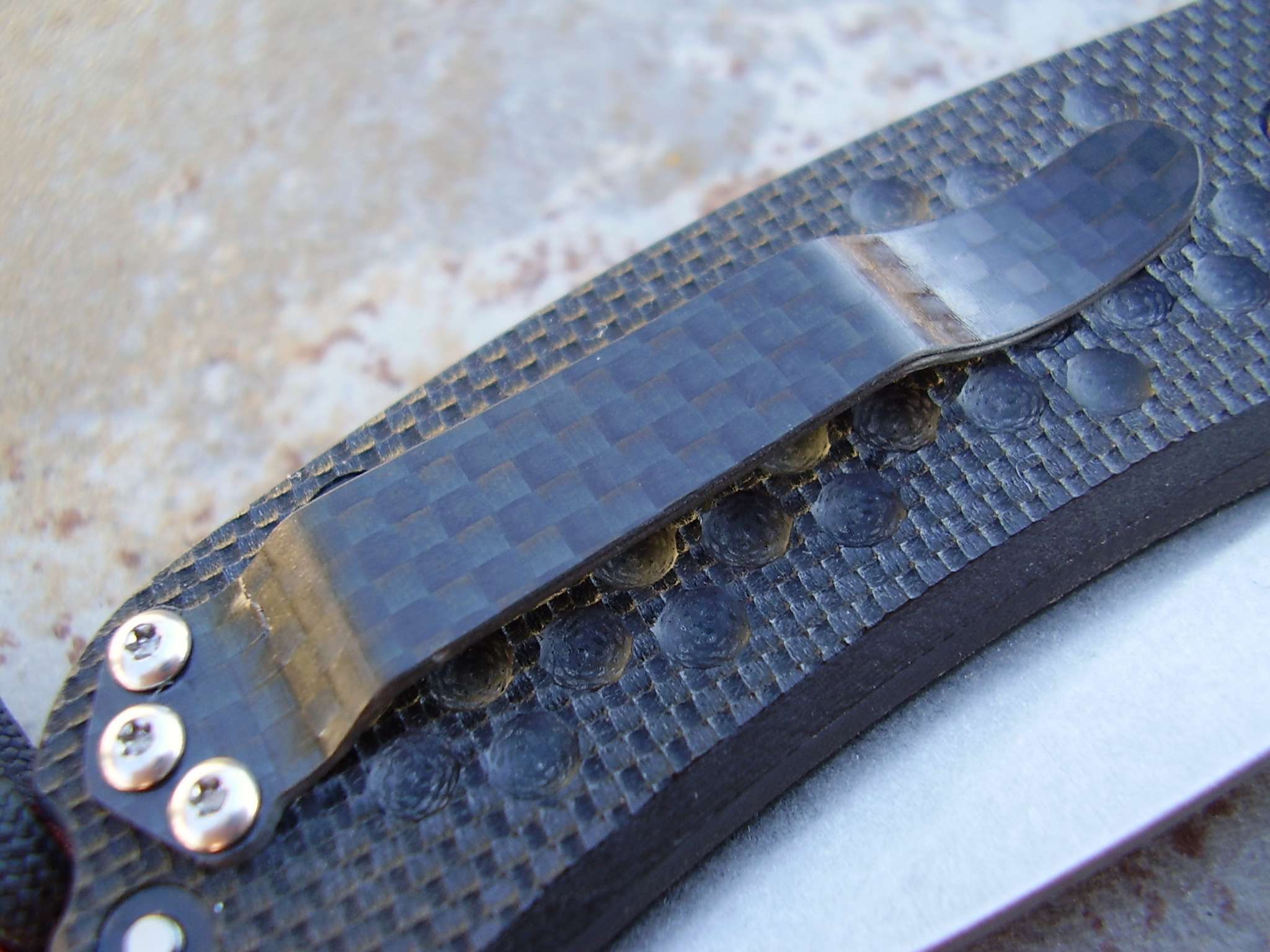

I rec'd mine today in the mail. After I had installed the clip on my Large Ritter Grip with Wilkins scales I noticed there was little if any retention, you could see a sliver of light between the clip and the scale.
I like a firm/snug clip because with my job I'm crawling under and around decks and have no desire to loose my work knife.
So, time to make some modifications---placed the clip in the vise---screw side down. Fired up the heat gun on high---hit the base of the clip for approx 30 seconds while putting slight pressure on the top of the clip until I could feel it soften. Pushed it to the point I thought would allow for a snug fit---let cool for another 30 seconds and PERFECT :thumbup:
The edges where quite sharp so I knocked the them down with 400 grit sand paper and they're perfect.
These are strong clips---like others mentioned concerns in regards to strength, I found them remarkably strong!!! I bent one near or close to a 45 degree angle as kind of a test to put my concerns to rest. Not a problem period in regards to flex---snapped right back to it's original shape.
All in all---nice looking, light and strong :thumbup:
A picture taken in direct sunlight.
