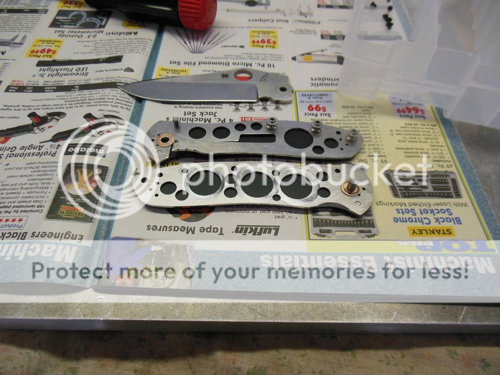

I do make my own custom fit PB's when called for to enhance rigidity as well smoothness:
On my Para2, Yojimo2 and Gayle Bradley2, although having solid pivot from the get go, all share original somewhat smallish PB's. All three benefited with oversize od, smaller ID to allow larger OD not to cause interference and with thickness remained same. Unfortunately no pictures to show the two former:

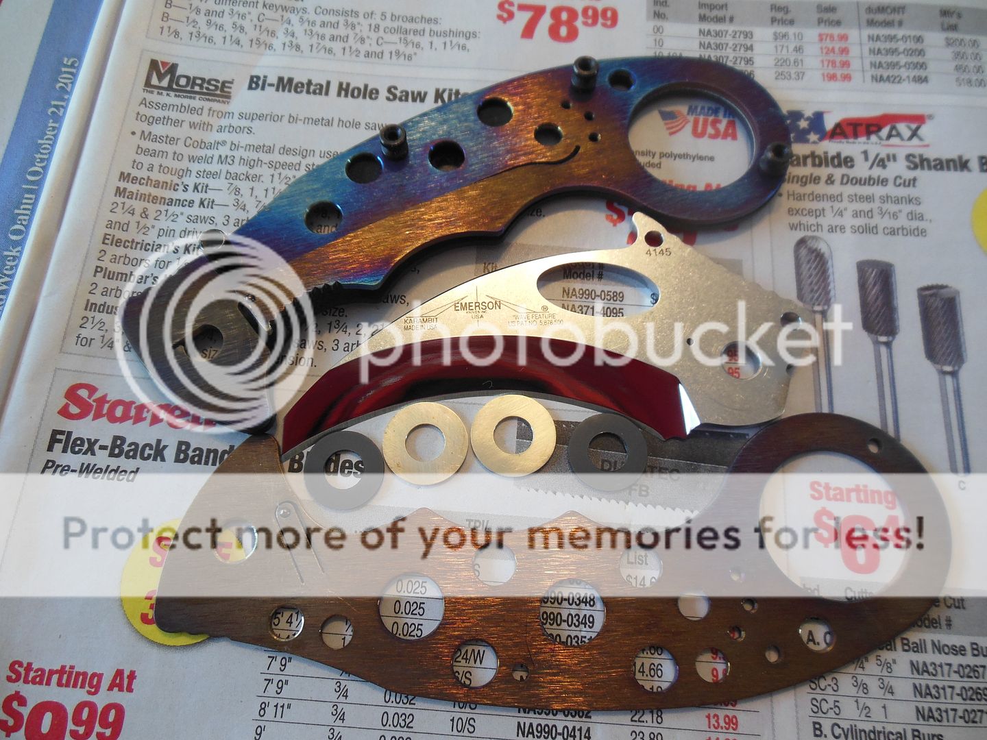

Emerson nylontron replacement shown having larger OD and smaller ID to improve the rather original shaky blade deployment:

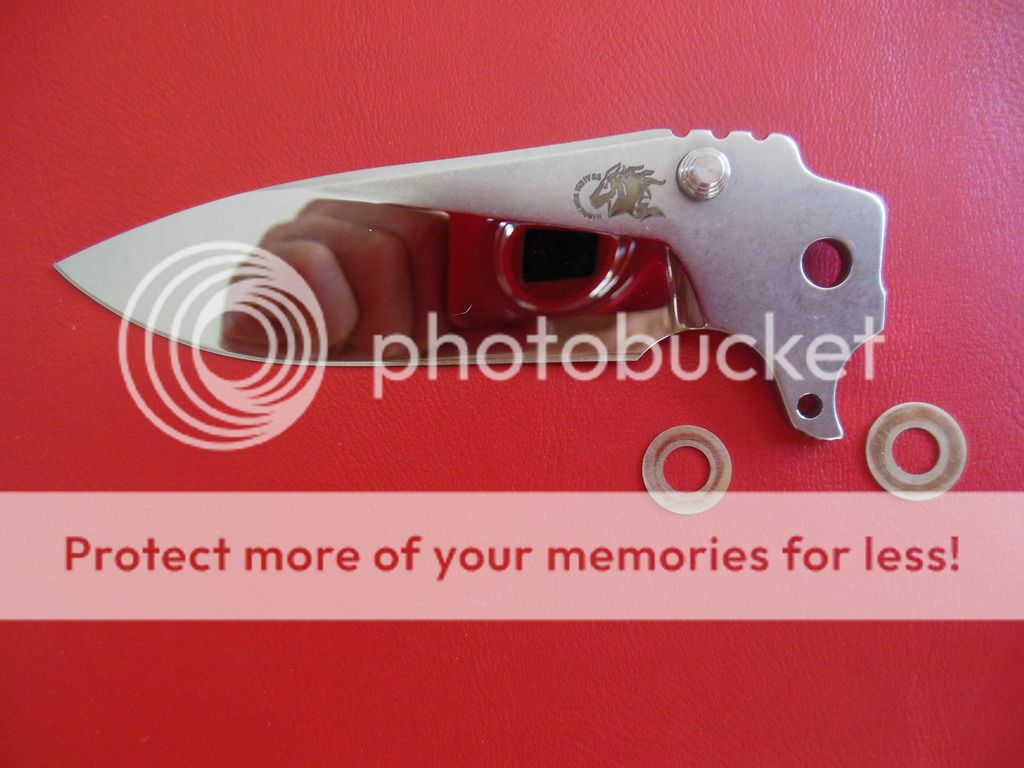

Two of my Hinderer XM's without unstable teflon:
Can you tell me more about the Spyderco washers? I own all three of those knives. How did you modify them?
Thickness remained same @ +- .0000", pivot washer ID reamed to + .001" over pivot OD, OD are unique to each knife, after careful consideration and having max'ed out OD size without interference to provide widest surface area to enhance blade support in open position.
