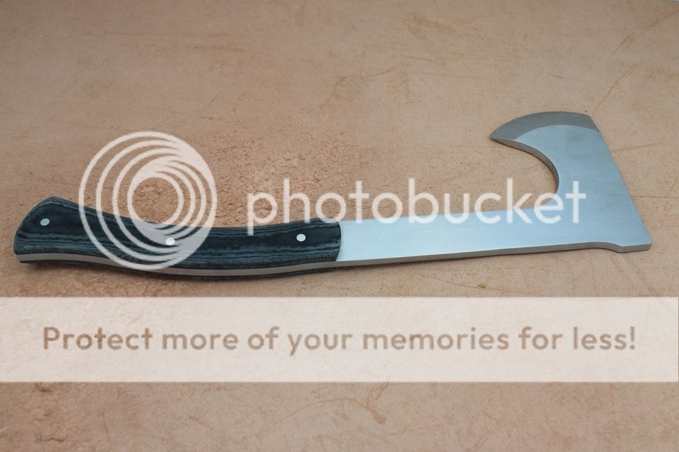

I am doing a small run of full tang hatchets, and I needed some guidance for the edge geometry. I will do some testing once they are heat treated, but I was looking for a starting point.
They are 1/4" 1075 steel. I will be aiming for 57-58 rockwell. They will be flat ground, with a convex secondary bevel
I would like to know what edge thickness I should use before sharpening? Does .04" sound right? With a 25 dps secondary bevel?
Depending on what the hatchets will be used on, that would be POK, but I would go down thinner. The convex grind at the edge will make for a stronger edge anyway. Try one at .020".
What is the intended use? I agree with Stacy, I think you can go thinner with the convex assuming they are for general wood use. I just made one with a bit more than that behind the edge, it's leaning towards carving over chopping though at that thickness. I also didn't convex the secondary and they are more like 20 DPS.
I just reread your post and saw that you are talking about .04" before sharpening. At that thickness I doubt you will be happy with the performance, testing will likely necessitate thinning down. Of course, chopping and cutting performance with a hatchet will also be hugely dependent on the primary bevel angles, since you're forcing a wedge shape into wood with much less actual slicing being done.
The general use will be chopping wood and delimbing branches. I will take it down to .02 before sharpening as you guys suggested, and see how it does. Thanks

Just a minor clarification - the .020" is the thickness at the edge after HT and finishing, but before sharpening. I would leave the edge at .040" before HT. After HT and sanding the bevels, the edge is left at .020", then the convex edge is sharpened on the belt grinder with a 400 grit belt..
I thinned down the edge to .02 and sharpened on a slack belt, to get a slightly convexed edge.
I chopped with it a little bit, and it seemed to hold up well. I will have time to test it more tomorrow.

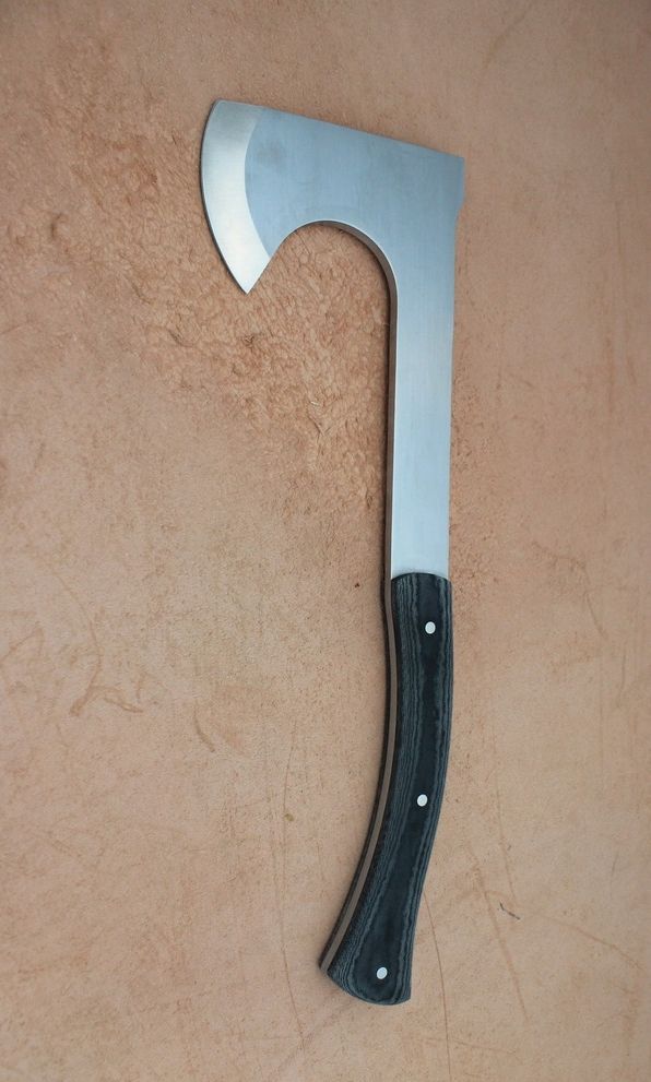

Thanks for the input guys. Here is what I ended up with on the first hatchet. Bevels were ground at 20 degrees inclusive, with the edge convexed at 25 dps. The handle was somewhat skeletonized, but I am sure I could have removed more material.
