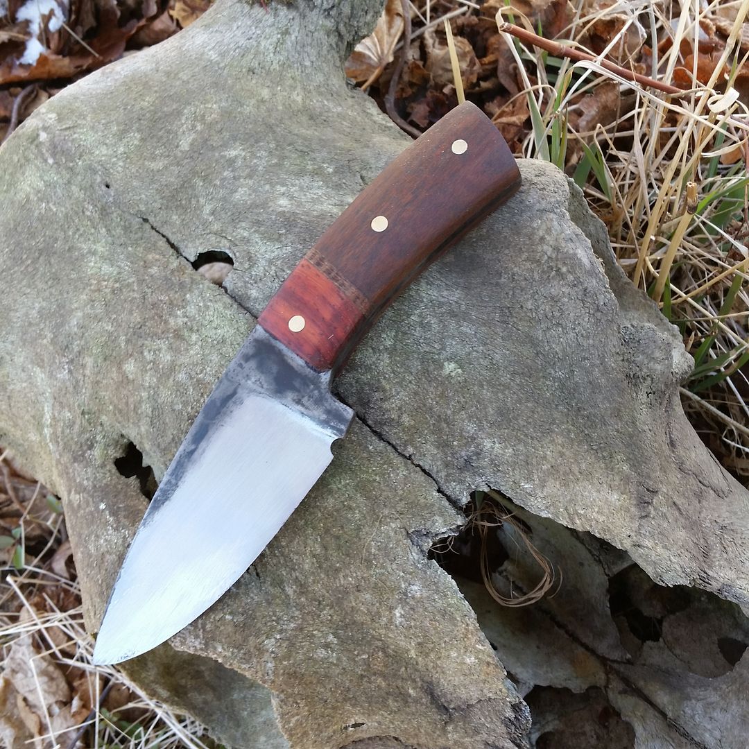

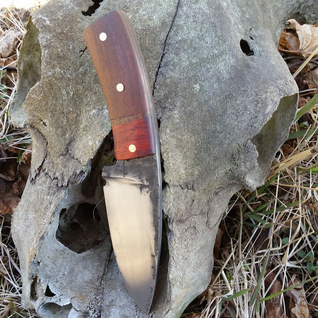

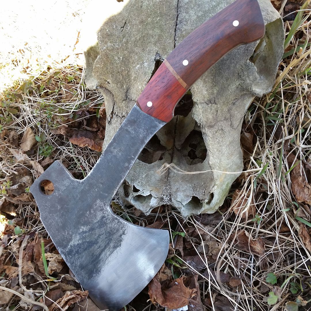

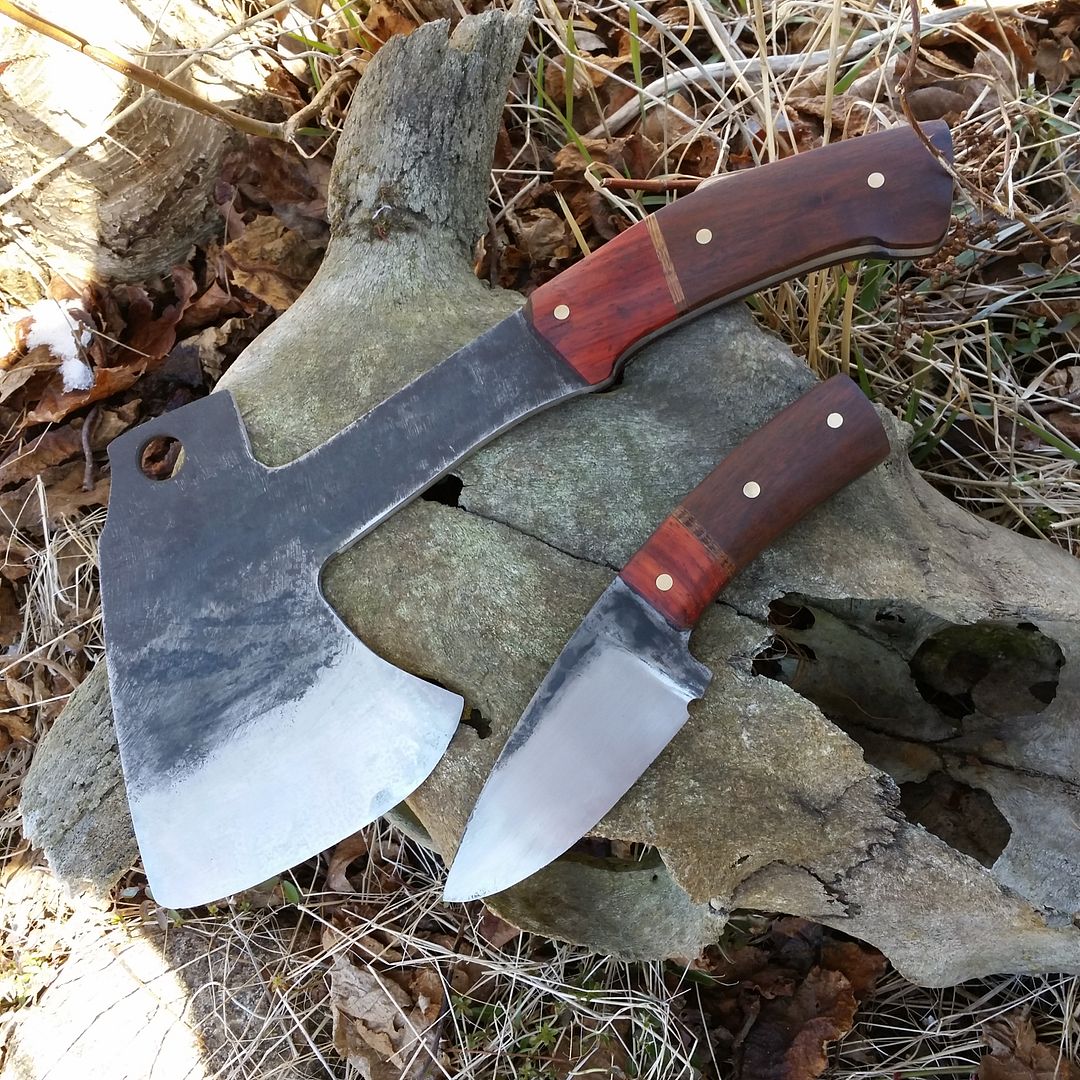

A nice hatchet and knife combo I made for myself to bring camping and for general hatchet use. The Knife a good EDC as well to take out and use in tangent with the hatchet on site and out in the wilderness, looing foward to field testing these this summer!
Both knife and hatchet are made from a 32" diameter saw mill blade, approx. 5/32" thickness
Hatchet is 12" long, about 6" wide at the head and edge is
Knife is 8 inches long , blade is 4" of that
Gun blue/Bleach texturing, edges machine and hand sanded to 320 grit. Handles are made of Brazilian Walnut, maple inlay and Paddock Bolsters
Fun personal Project ,looking forward to doing it again

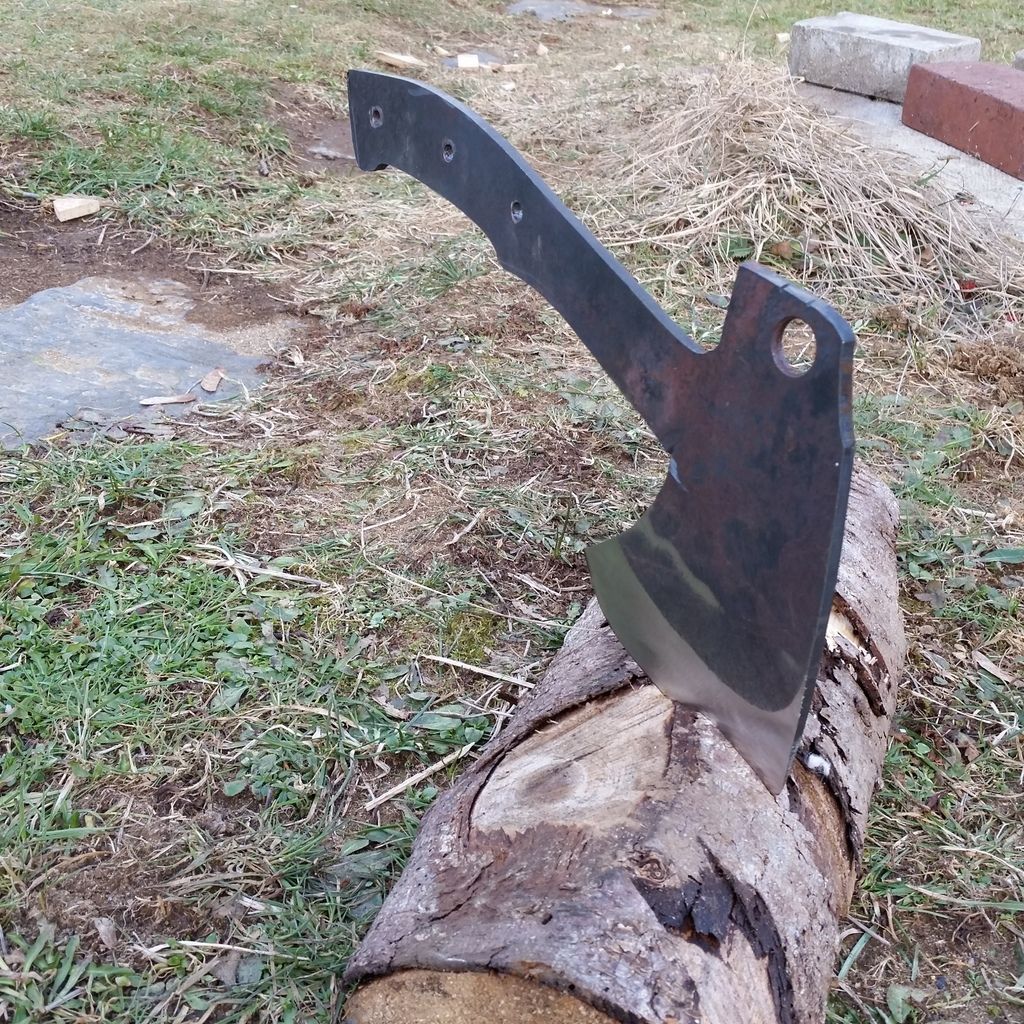

Before the scales were put on
