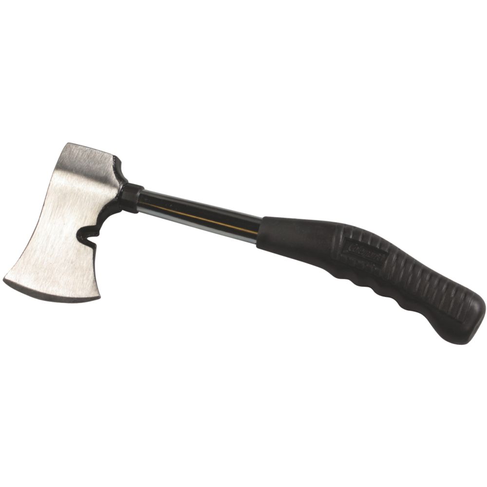

The worst hatchet I have ever used was Coleman Camp Axe. I am usually happy with wooden handles.
2000016377_Hero

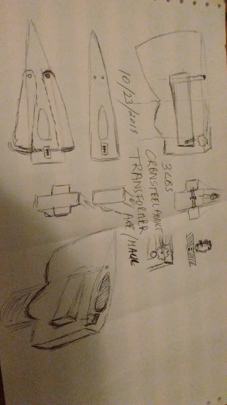

There comes "Securis The WingNut" (axe/maul variable geometry transformer). Regular axe shape when felling or limbing. When maul is needed just keep turning the wheel/nut on top of the poll and spread side bars apart . The design could probably work with 3lbs axe head

There comes "Securis The WingNut" (axe/maul variable geometry transformer). Regular axe shape when felling or limbing. When maul is needed just turn the wheel/nut on top of the poll and spread side bars apart . The design could probably work with 3lbs axe head
