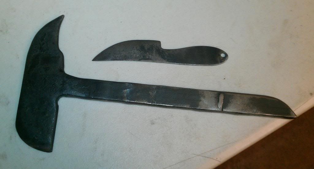

Here is an unfinished hawk that was pretty easy to put together. Ground, welded, and forged from a leaf spring to make one single piece of steel. Really not a lot of effort involved.

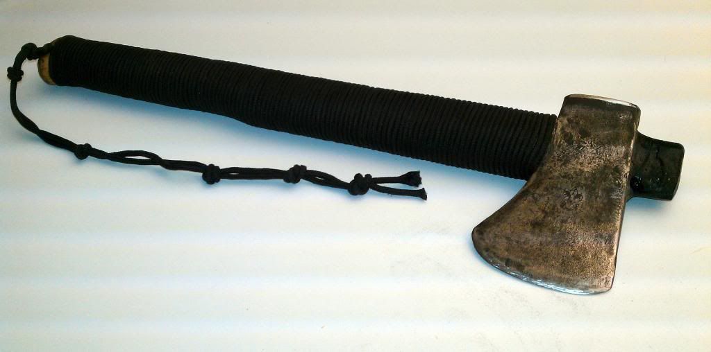

I kind of done that, not for the sake of making a tommy, but because the hatchet was beaten up and not being used. I wanted a smaller bearded axe as I already had Gransfors Bruks sfa and decent tomahawks. Did it slowly with an angle grinder and a file :)
it's a good axe, used mainly on stuff close to ground as it's a beater and has a short handle, but atleast it now gets used/abused!
