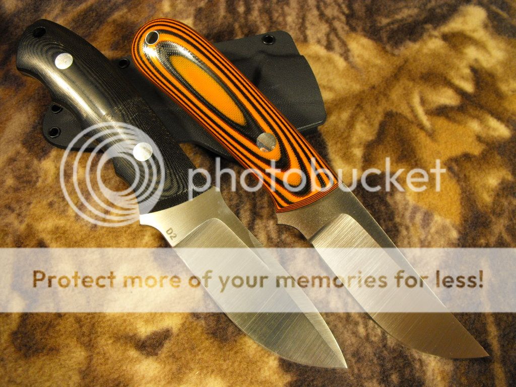

I've heard that D2 can stain too, but take a look at my 15+ year old Dozier Pro Skinner is at the bottom of the following pic. This knife has performed years of camp service and skinning chores and seen quite a few miles. It has seen time along the salty Alaskan coast and the interior of the state too. From potatoes to moose, this blade has done it.
There is wear on the black Micarta scales from friction inside the Kydex sheath but the blade could almost pass for new. This knife has seen some serious use as a cutting tool but it has also been taken care of along with the rest of my gear while out in the field. A rinse and a wipe down, but nothing more than that. No patina here!
