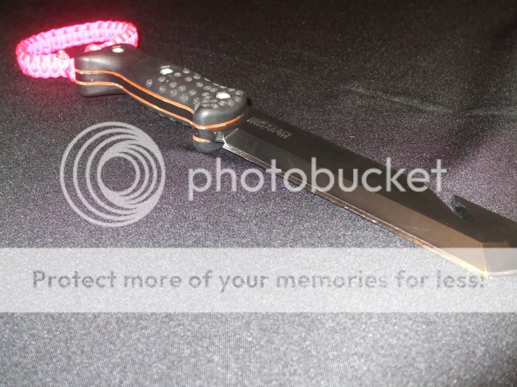

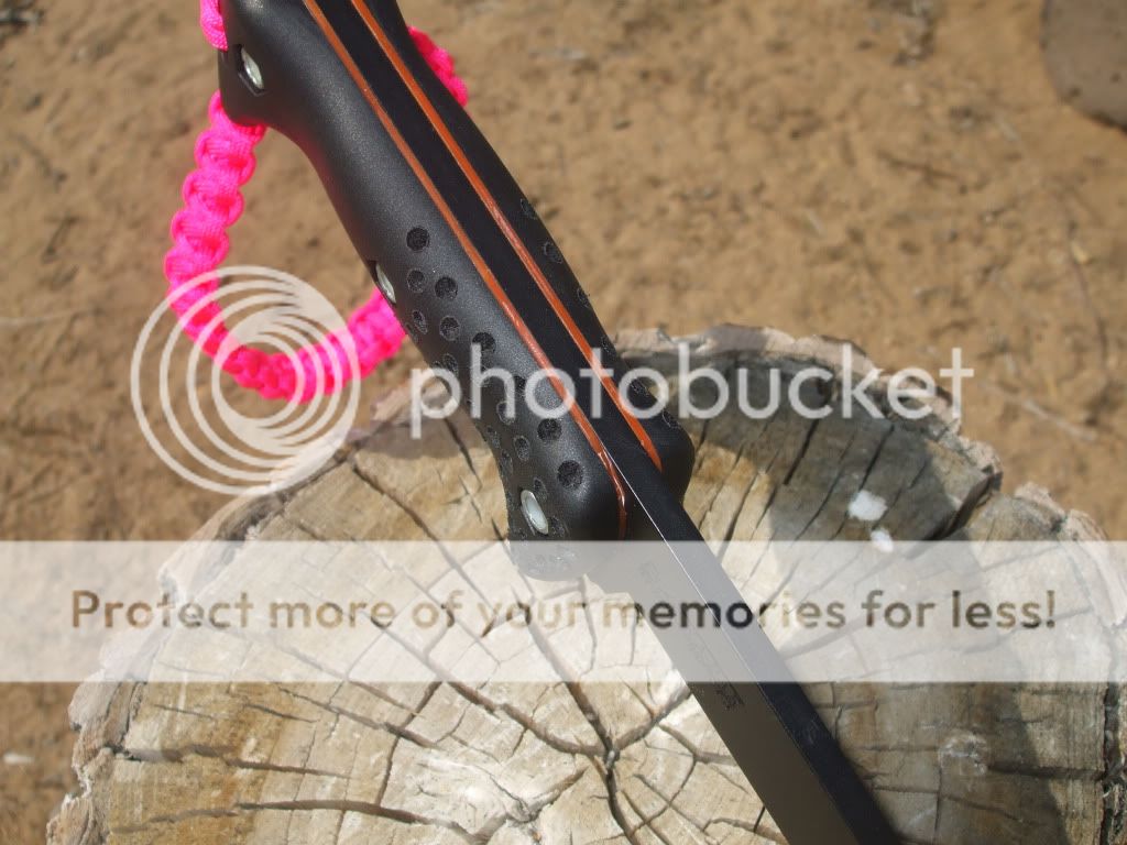

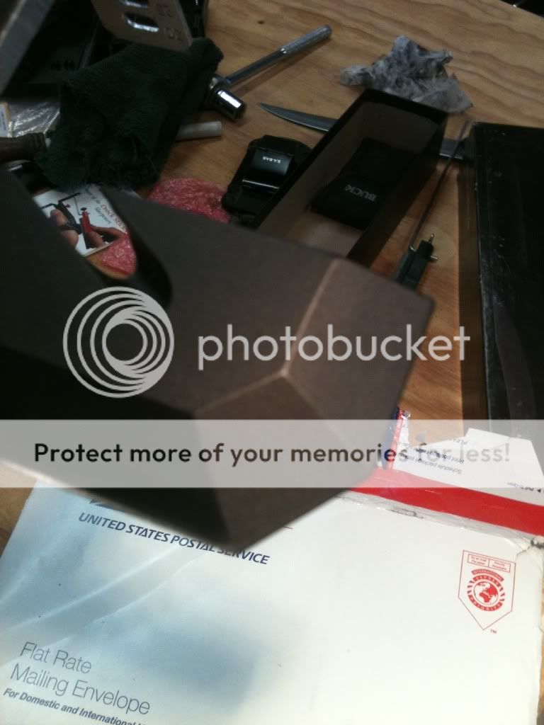

I'm to cheap to pay full price for a bk3,I saw a blank on fleabay and could justify the price and might just learn something.
I figured it's pretty close to start with and I could use my lansky.

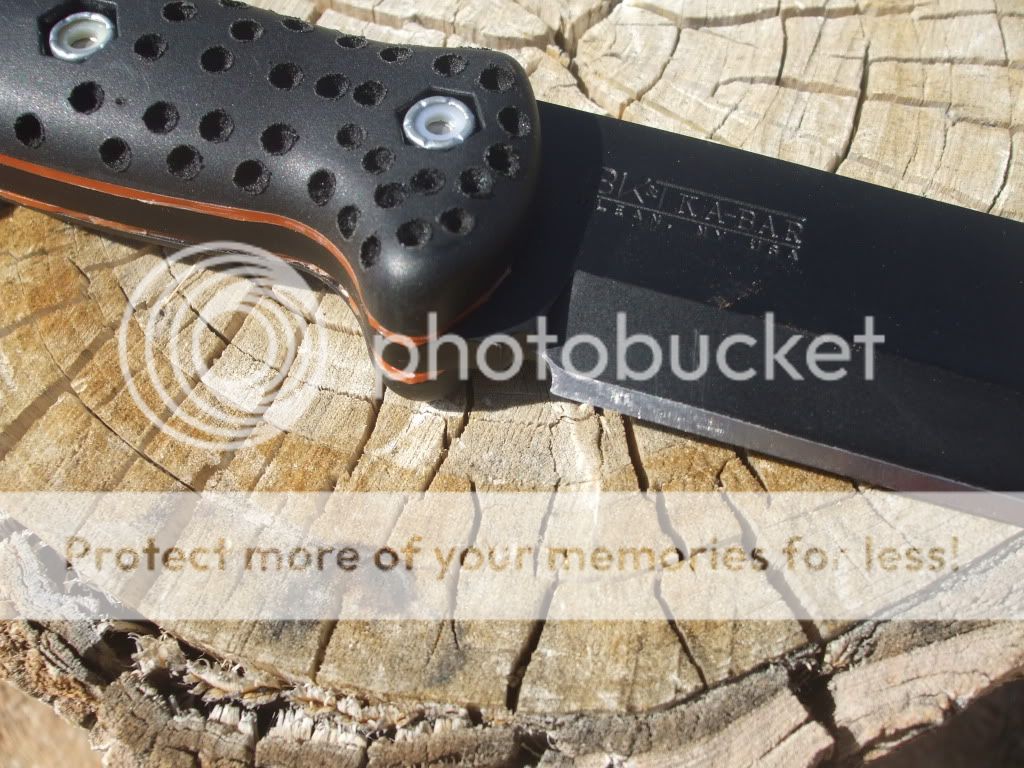

I got a pretty good edge on it atleast I thought.

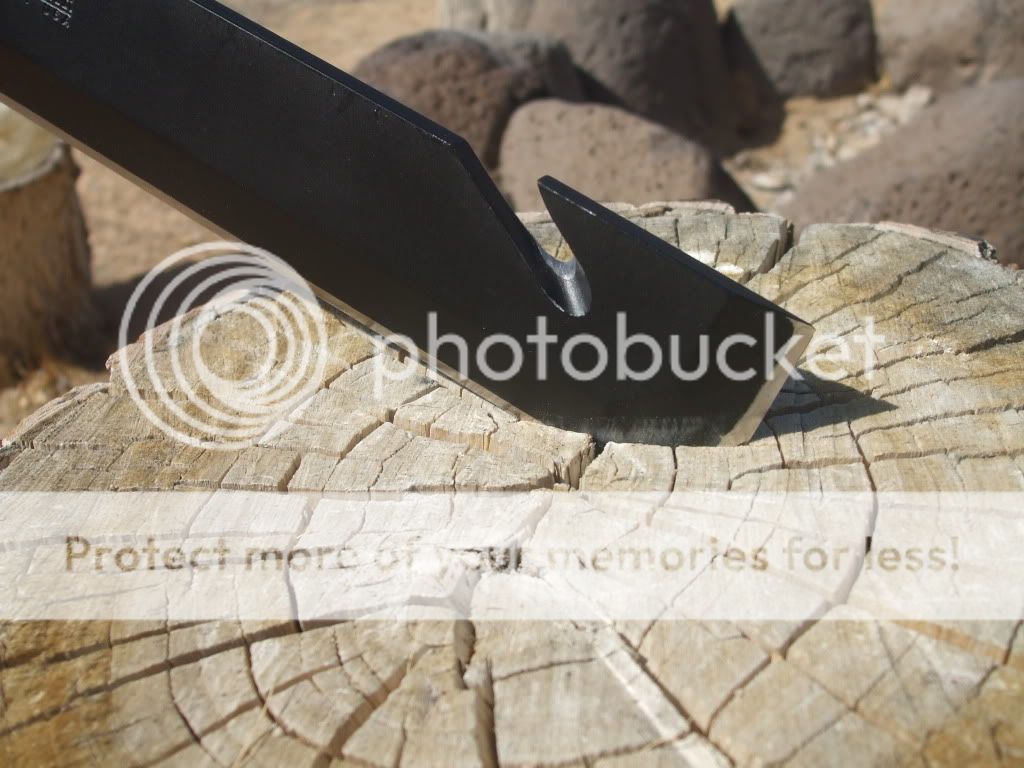

I haven't attempted any serrations yet but did get line hook good and sharp. I made liners out of home depot bucket lid, not pefect but good practice for kydex liners down the line.Pink lanyard so I can find it easy in emergency box,plus my daughter thinks it's cool. I LIKE IT!!!
Really nice, mind if I do a review on it? Just kidding, but it is really nice, I don't even think the florescent pink bracelet is overkill, working at Boy Scout summer camp, it's the only color keeps staff stuff with the staff.
The only serious question I have about it is why are the dimples so deep?

Hey oXide, the grivory is a little slick and i might of went a little overboard with the stippling but the grip is really improved! I have a couple leftover handles that I've replaced with micarta. Because this was a blank I've got to use up some leftover knife parts( scales, sheaths) most of all it was fun and a learning experience. Have a good one man !
Looks really good Guineaman, I like the look without the serrations much better. The scales look good also.

Freakin' awesome. The serrations are there to support the chisel grind, when it comes to cutting material, if you got a good edge, which it looks like Gman did, then, ta hell with them serrations.

so the blank still has the linecutter? dang, thats the only thing about the 3 I dont like. Was hoping when I saw ''blank'' in the title it was un-hooked.
still, a nice job finishing it out.

To be fair, it's not a line cutter. It doesn't come sharpened from the factory, even on finished BK3's. It's designed to be used as a chipper. A few minutes with a chainsaw file can turn it into a decent line cutter, though.
But like you, I'd be happier if it wasn't there.
and a grab hook for wires, and snagging line, and sure, you COULD cut paracord or stuff if you want, but it's NOT a seatbelt or other cutter, despite the close similarity.
but as stated, you can put a wicked edge on it with some work.
