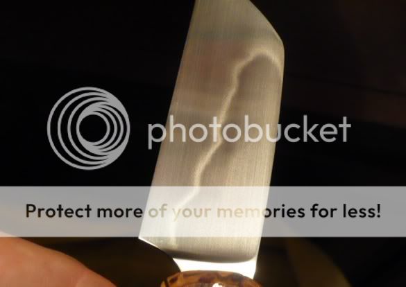

Just wanted to update that I tried the suggestion to clean (I used Windex), rinse under water, and go right into the etch wet and it worked much better, so thanks again for the suggestion!
Here's how it turned out:
Very cool stuff Paul!!!

You're right about the hamon, the little whispy stuff isn't there in that blade, so the extra elbow grease for the other crap I do (in that thread) wouldn't do you any good. But that isn't an attempt at making this post a "back-handed" compliment. I just wanted to agree that you cannot pull something out of the steel with the finishing techniques if it's not in there to start with.
It's a beautiful line with a great finish! :) :thumbup: :cool:
