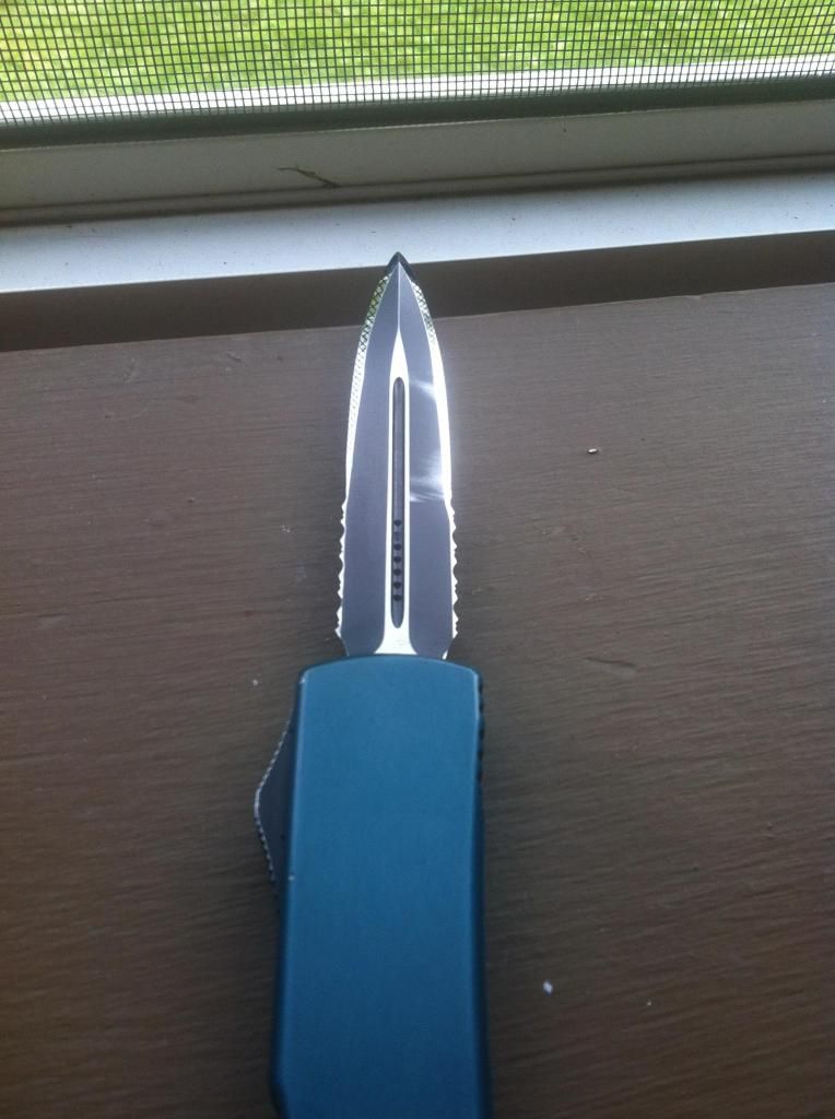

So, I have a D/E ultratech, i love it, but it just has never been all that sharp, even when i first got it. the only sharpening system i have is a sharpmaker. which works really well for almost everything i have, but i feel like i just make it even worse on the ultratech. I'm really afraid to keep going as i do not want to ruin my edge. Any professionals around here to help? :)

I sharpened this microtech for Sinister and I will never sharpen one again. The blade grind itself is almost 20 degrees on each side so the edge grind is so obtuse its like sharpening a splitting wedge. Took a lot of effort to get a edge sharp enough to shave arm hair and even that was less than impressive. Best I can say is good luck, it was not designed to be a cutter.
Thank God, I'll try to post pictures when I'm done with this, 3 days of trying to work with the factory grind on this has been perturbing, especially since the tip is about 60 degrees and the rest was about 50 degrees, a common occurrence with factory sharpening and usually easily handled on a single edge, the double edge with double the sharpening inaccuracies on a dagger is mind bending.

Finished it, definitely not designed to be a cutter, I have no doubts that it will cut better now and shank with ease.
