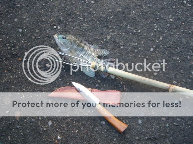

I just use bamboo for shaft

I made the gig from 5 SS rod bend them and use chisel to punch out the barbed. hold them with tape and wrap with safe wire to hold the prongs in place them inserted in to bamboo shaft.
Another way to make the barbed is to flatten the tip with hammer then use file to file out the barbed
The idea is from Formosa mountain tribe people, they use this 5 prongs gig in pond, and stream and 3 prongs in sea.
The knife is Japanese style stream(fishingman) knife but it is not made in japan but by a Taiwan rural countryside blacksmith who learns the heat treatment skill from a Japanese blade simth back to WWI.
