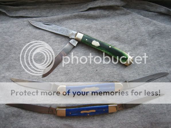

Here's a Fight'n Rooster - sorry I thought I had a better picture of her
I did some google searching for the Fight'n Rooster - no luck. I did find some interesting pieces though. I've said before that I don't really understand the regular muskrat design, some congresses, and other multi-blade knives that have redundant/identical blades. My search turned up several examples of not just 2 blade muskrats, but 4 blade muskrats. I was laughing heartily at those...until I saw their 16 blade muskrat.:eek: Looks that some are clips and some are wharncliffes. Yeah, I know it's a presentation piece rather than one intended for actual use, but still, I had to laugh. I think I'll stick with a 2 blade version.
