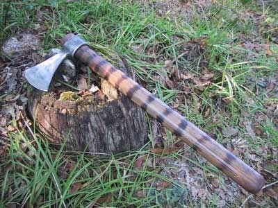

OK, here's a photo of my first attempt at dressing up a tomahawk. This is the Cold Steel Frontier.
• All paint removed from head using wire wheel
• Bottom end of handle reshaped using belt sander (use caution - it takes a lot off very quickly if you're not careful)
• Sanded original clear coat off of handle
• Used propane torch at lowest possible flame to very lightly burn rings.
• Sanded after burning
• Applied two coats of Minwax water-based stain, American Walnut
• Applied two coats of Formby's low-gloss Tung Oil
• Removed set screw and reassembled
I will either add two brass upholstry tacks near the bottom of the handle, or add some rawhide (probably the brass tacks).
