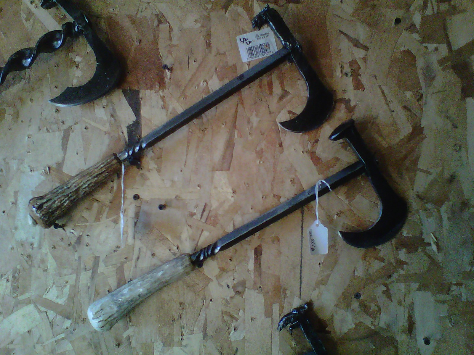

These are a little different, but they are interesting. . .

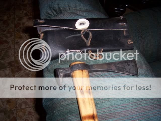

The last one is mine,rr spikes are a very aggravating material to make hawks from,because 5/8" is not a lot of material to work with..I used to make my handles but now buy unfinished and do my own finish,teardrop shape and usually 19" or so in length.If you can make a hawk from a spike you can make one from anything lol,so go for it---Regards Butch
