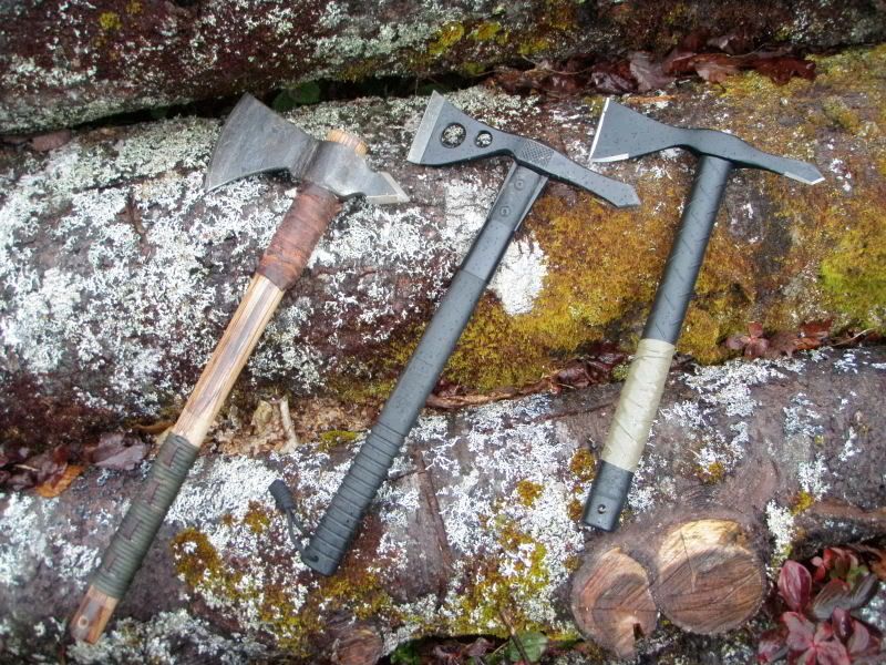

In another thread someone asked how the ATC V-Tac stacked up against my Fort Turner Rogers Rangers Hawk.A good idea but I thought..."I have 2 V-tac-style hawks,Why not make it a tripple header"?
The combatants:
The ATC's V-tac
Fort Turner's Rogers Rangers Hawk
and Sog's Fusion V-tac

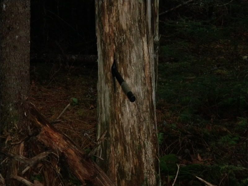

First category:Spike penetration.

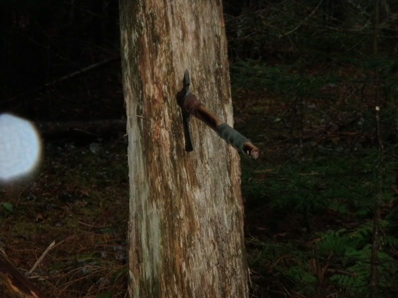

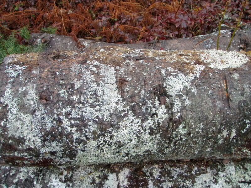

I would allow for 10 strikes to see if it would stick.The target was a seasoned old log out back

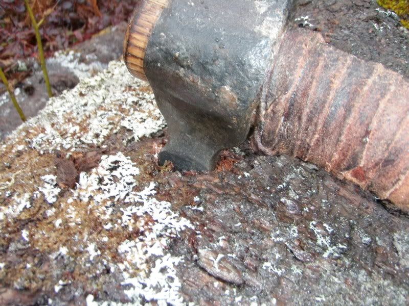

The Fort Turner Hawk stuck in 2 swings.The wide but shorter spike would crush and stab all at once.

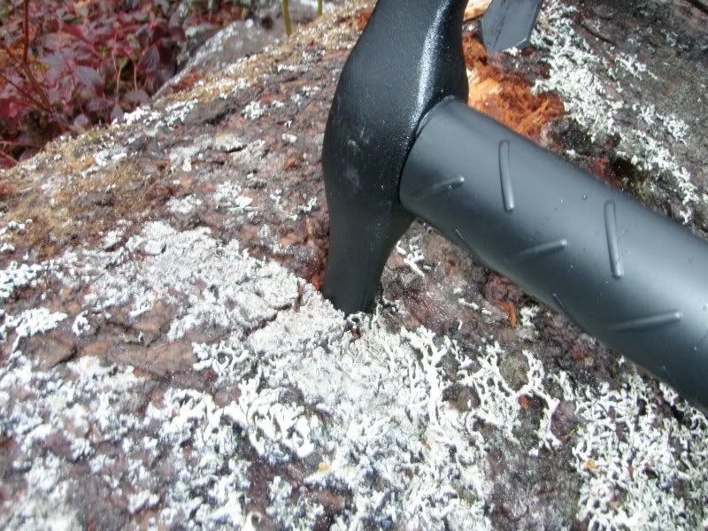

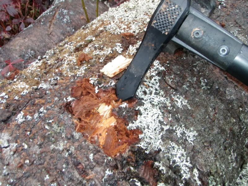

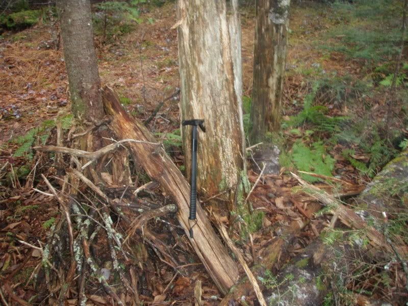

The SOG was next.I took all 10 swings and no sticking.It just dug a small hole and kept bouncing off.
The V-tac was last.It stuck so well I needed to twist it to get it loose.1 swing.

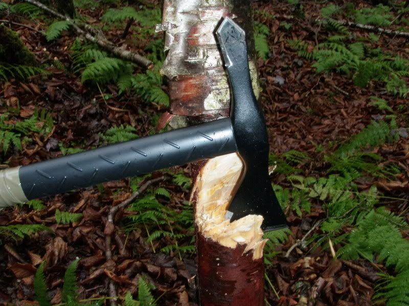

The Rogers Rangers haws went through the tree in 9 swings.It's heavy head and long handle make it a decent chopper.
The sog was next.It went through in 14 swings.It's lighter than the Rogers Rangers hawk but almost the same length and it showed in the chopping.
The V-tac was last.after 35 hits and only getting a little over half way through I called it quits.The edge is as-is from the factory.

The grips of the 2 V-tac hawks were quite different.The SOG has a very good grabbing grip made right into the handle in the form of rib like cut-outs.The V-tac was vastly different.The handle comes quite slick.it was raining today so I wrapped it in 100MPH tape for the test.Both hawks have lanyard holes.I didn't include the Rogers Rangers hawk here because I have extensively altered it's handle to my liking.It wouldn't be a fair comparison.
