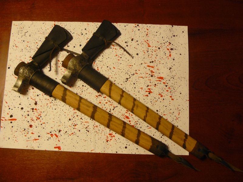

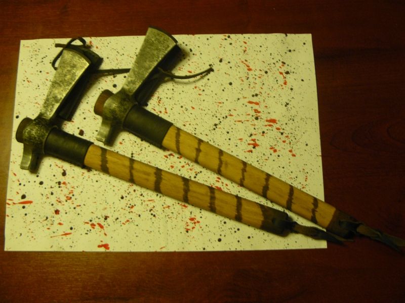

Finished a while ago, sorry for poor photos.
8 inch with 1,5 inch cutting edge for the Spyky and 6 inch with 1,5 inch for the Tommy, 14,5 inch handles, and 1 oz. overall weigth.

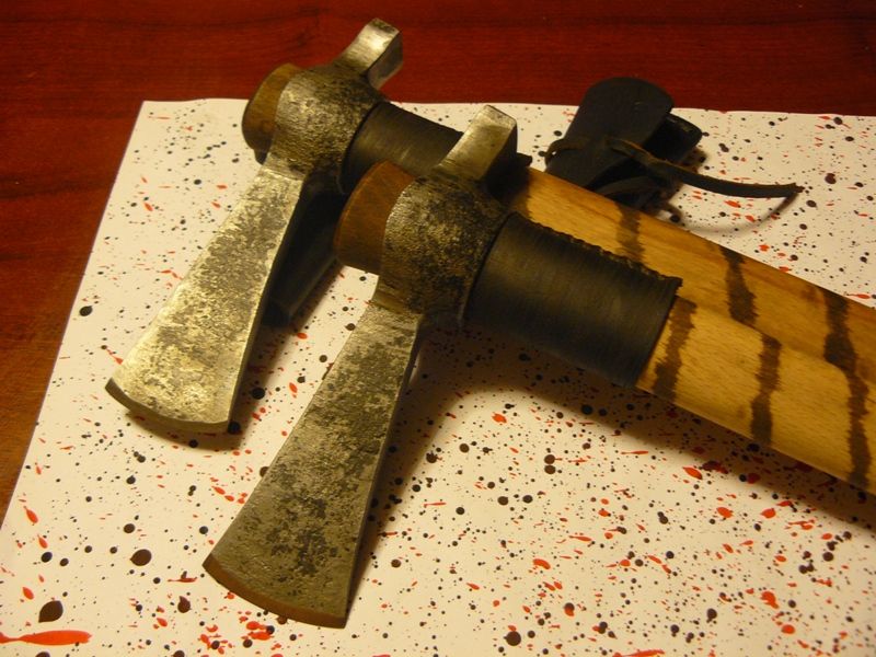

How do you make them? They appear to be cast, by the finish on the un-ground parts. Are they modified Cold Steel spike- and trailhawks?

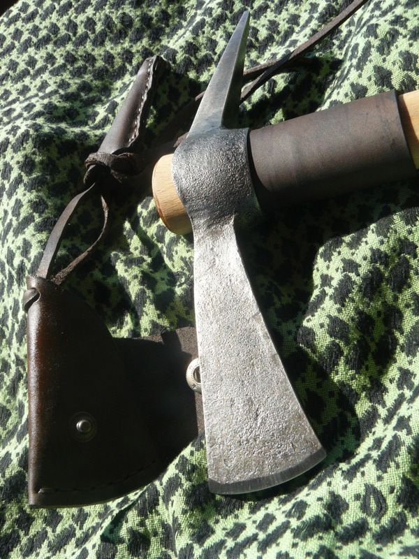

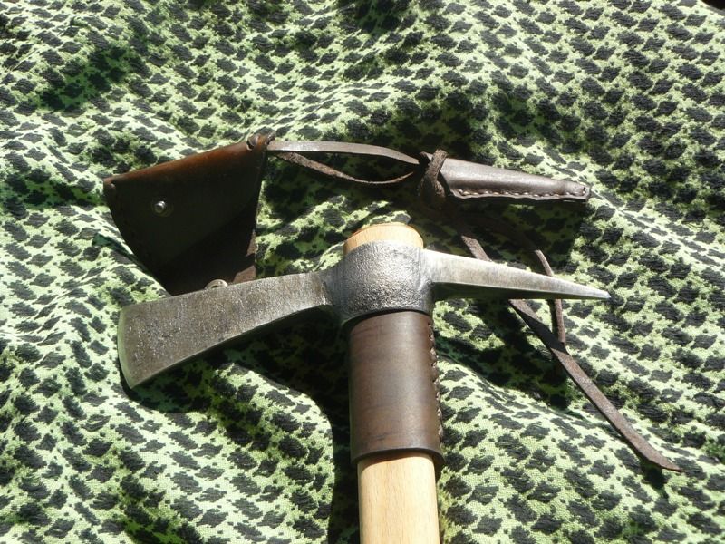

I use / modify some mason hammers (by forging the blade and the hammer pole/spike), dropped forged types.
I try to use cast made hammers but they break when I forge the blade/spike/hammer pole.
