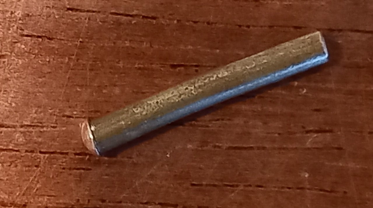

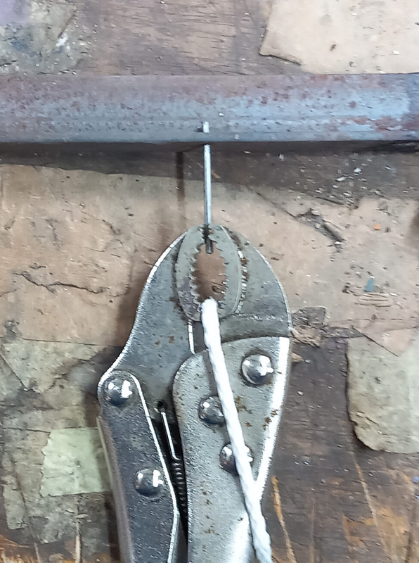

I'm testing a self made head spinner. I did a quick test on some 2mm~5/64" brass roundstock.
(That is also the diameter I use for the middle and back pin on slip joints)
I get an app. 0.35mm~1/64" wider mushroom head on the pin.
Is that a good result or should I try to get a bigger mushroom?
This is the best pic I could take:
That's a fantastic result, did you make it on a lathe?

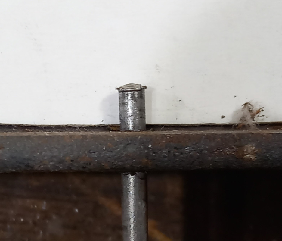

For now I am testing and seeing what works for me.
I'm impressed with how strong stainless steel is.
Here is a quick 1/64" head on a 5/64" pin that I spun. I hung on it with my 175Lbs and it held!
That is a very small ring of steel holding my body weight!

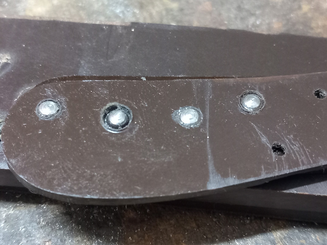

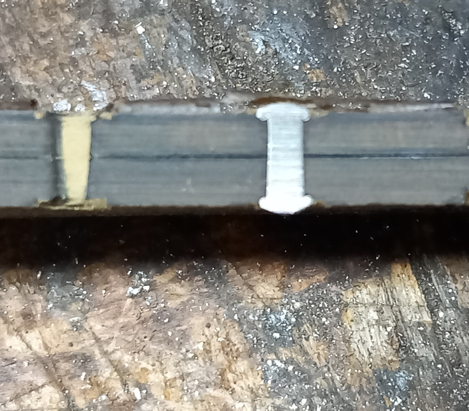

Did some testing on stainless. It gets hot but I get a good mechanical bond.
It's hard to take good photo's of but I like it when half the mushroom is in and half is above the material.
Now I'll see if I can get some rubber polishing bits to polish the spinner and pins afterwards.

Third one looks flipping brilliant,
overall I think that's it just one more thing for me to mess up. I used to do a bit of solid riveting on aluminium panel vans, we used snaps and dollys, much like Bills method, seems far less prone to catastrophic calamity and failure.
