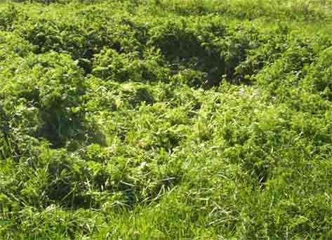

Light vegetation :
The bowie cuts light vegetation well when sharp as will any blade. With a razor hair shaving edge it literally floats through the vegetation. The heft is again of benefit and allows it to plow through thick vegetation cutting a very wide swath with little effort on the swing :
http://i7.photobucket.com/albums/y269/CliffStamp/Heafner%20Bowie/hb_bed_swath.jpg

It easily cut light weeds, it functioned similar to a saw, I could feel more aggression than you get on a freshly sharpened blade, but there would be no difficulty cutting enough for thatching, bedding, insulation or food :
http://i7.photobucket.com/albums/y269/CliffStamp/Heafner Bowie/hb_roof_weeds.jpg
