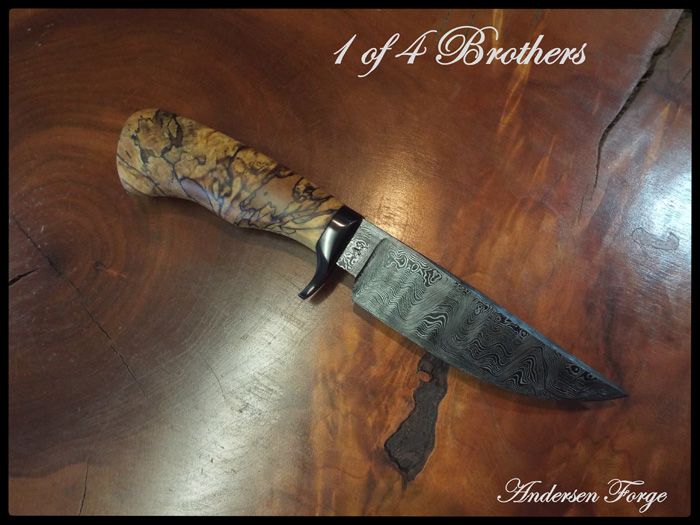

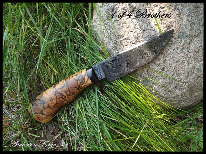

So, here's the first one for the demo and the first of four for the customer.
Some of Pete Crowl's end-grain, spalted Maple which has been stabilized.
324 layer 1095/15N20 with some nicely forged-in chatoyance, and a hot-blued mild steel guard.
I hope it's a fun demo 'cause I just about wore out my camera!
