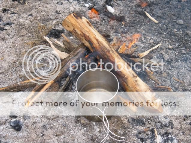

It's time to make a fire and this is where you stop:

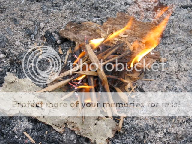

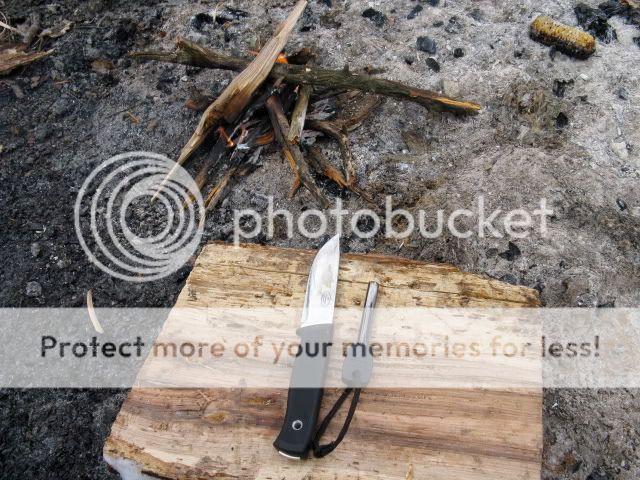

Uh oh you forgot your fire kit with all of your new-fangled expensive mail order tinder and vaseline soaked balls! The snow has been melting and things are wet. Fortunately you always keep your ferro rod and knife on you so at least you have that (bowdrill fire another time). Dry tinder is ALWAYS available if you know where to look.

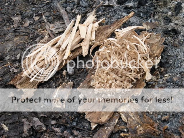

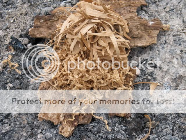

I found a 2 inch thick dead branch that was wet on the outside and split it down the middle, then quartered it lengthwise. From there I made heartwood scrapings for tinder, and various size kindling (think pencil lead, pencils, cigars, etc...) and laid them out on dry inner bark.
5 minutes later I had this:
Using only this:
And made some of this for hot chocolate:
So the moral of the story is to carry all of that junk in your kit but make sure that you are proficient in practicing the basics. I am no expert but have been practicing. Believe me when I tell you that this looks easy but it isn't. I had many failures along the way but that is how you learn. Get out there and practice until you think you got it, then practice a whole lot more. Thanks for sharing my Saturday afternoon with me. :)

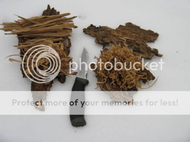

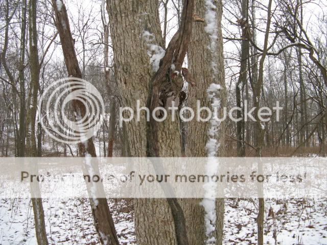

Just because you had a success doesn't mean you can do it again on demand. Early on I did this and got cocky, 2 failures later I had to regroup and look at what I was doing wrong. The problem was with my scrapings as it turned out. Today I went back to recreate the experiment with the exception that it was colder and snowing. Again no tinder other than what came out of the branch I used.
The dead branch I used is visible right in front of the tree:
Prep pictures:

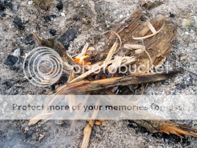

We've got fire!
Sometimes it's easy to get lost in what you are doing but try to remember that the whole reason we do this is to enjoy a little taste of nature. I sat there for a half hour listening to the sound of the fire crackling and the snow falling. If that's not peaceful I don't know what is.
I just cannot get flame from a fero rod and shavings. I keep trying. I have the same firesteel. What am I doing wrong? (I use the striker they provide). If I use some "fluff" from some elephant grass in the yard I am good to go. But I dont count that... its not "natural". Of course if I use petroleum soaked cotton balls, no probs at all.
The small tinder I used was scrapings not shavings, much thinner almost see through. Take your knife and hold the cutting edge toward the wood at a 90 degree angle then scrape it down. You will see small curly scrapings start to fall off, that is what you need to ignite with the ferro rod. If you want to see the guy that taught me this in action take a look at this video of him doing this in the rain. That is my next goal after it warms up a bit.

I didn't use the mora for the prep work, it was in my bag and I figured most people would be able to use it as a frame of reference for size.
