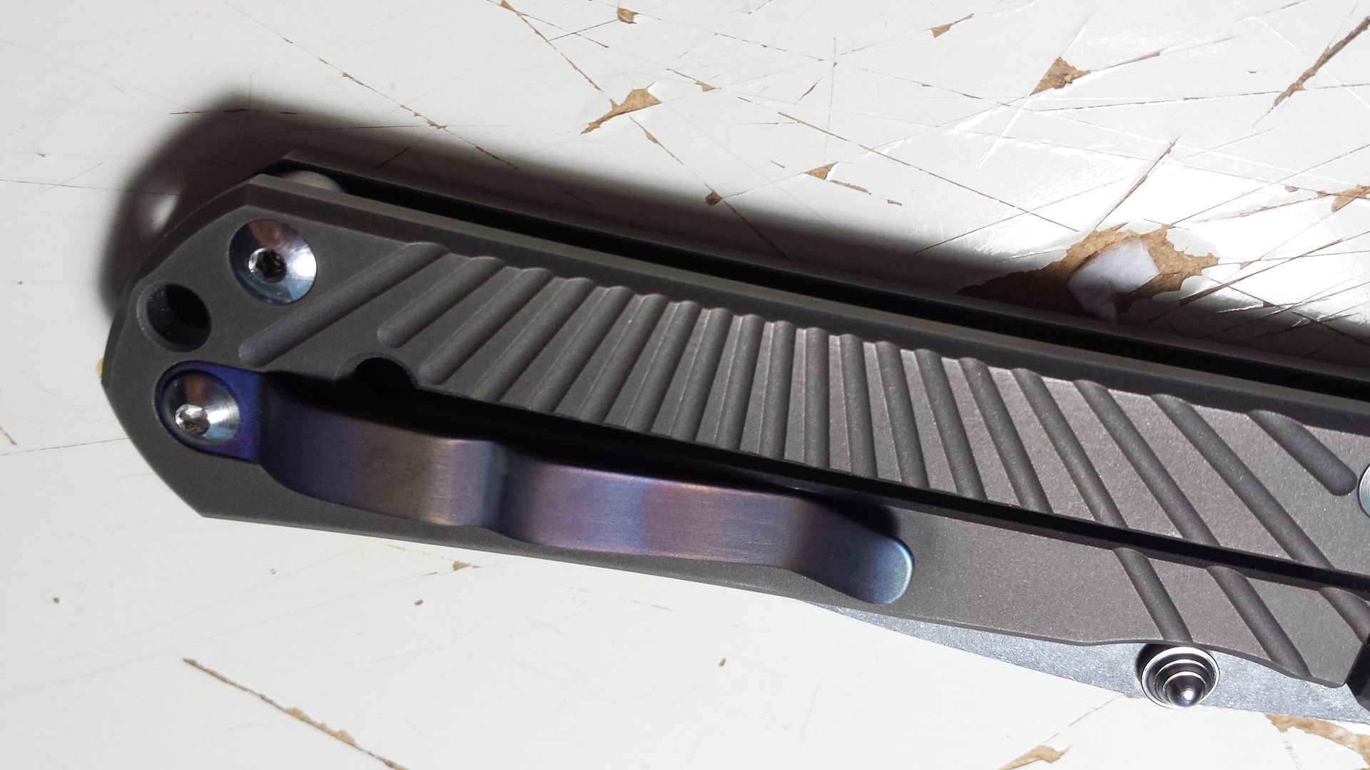

Previously I had my clip with a dark bronze-grey finish. I wanted something to contrast the dark grey scales of my starbenza (oxi-treatment) and decided to heat anodize the clip! It turned out well and I think it looks very nice. If anyone is curious, I also re-posted an old picture of my starbenza following the oxi treatment where I had acheived a dark bronze color. Overtime that color does wear away mostly due to the finger oil darkening the bronze finish.
Anyhow I hope you enjoy the pics.

Its pretty easy to control the colors. A nice rich bronze is attained by heating it right before it starts glowing and a deep blue/purple is attained by getting the metal a nice glowing orange. You can usually see the color form if you take the heat away momentarily. Intially I had it blue, bronze, blue, bronze, blue but later I decided to blend the colors together. You can still see the distinctions in the colors though.

I agree as it can be a bit random and will show any anomalies in the Ti that chemical anodising tends not to. That said with bit of practice and good surface prep you can get pretty good results using heat. The oxide layer forms quickly so you need to know when to stop to get the colours you want, espeacially on smaller pieces that obviously heat up quickly. Also any oil on the surface after it's been done totally kills the colour so you need to keep it clean. :)
Interested in replicating your clip, can you get into what you did for surface prep ?
It's pretty simple. Just wash it thoroughly with soap to get rid of any oil and wipe it with some rubbing alcohol if you'd like to remove any residual oil. Hold the clip with a pair of pliers and use a butane lighter to heat the clip to the desired color.
Well torch or lighter it doesn't matter. I just used a butane lighter because that's what I had. And being that the clip is small a large torch may make it hard to attain alternating colors if that's what you want.
