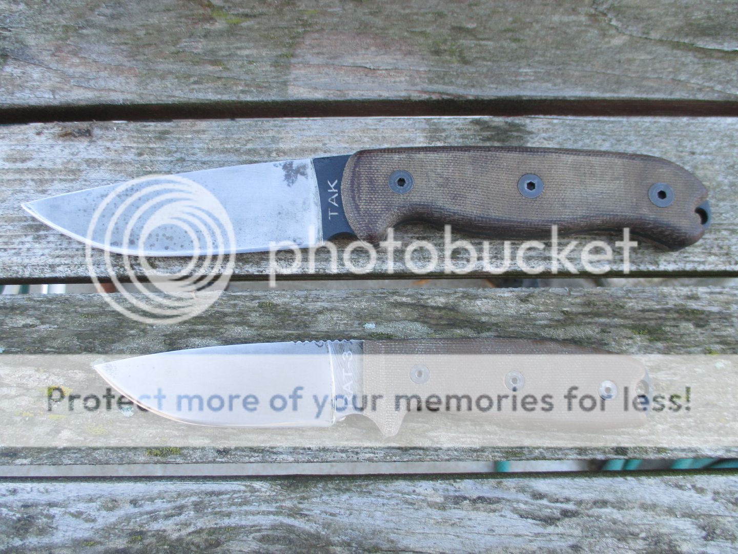

This is what the RAT-3 looks like today along with a TAK-1.
