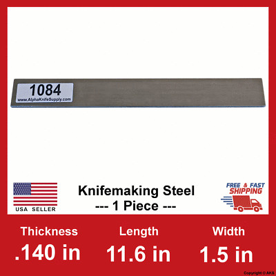

Time to buy some 1084 or 1075.
This is 1084, you can get this stuff at almost any knife supply and even ebay! Alpha Knife supply sells it on ebay which is the link I have posted. For $20 including shipping you could make a awesome knife out of this stuff using your coffee can forge.
+1. 8670 from Pop's Knife Supply is also pretty easy. The only thing I will say about eBay though is to only buy from Alpha Knife Supply on there. There has been trouble with non hardening steel from others on eBay in the past.
