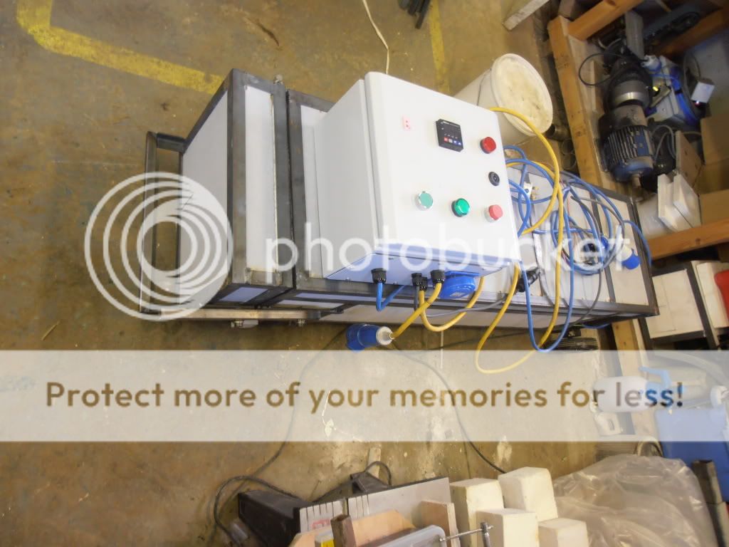

Why not build your own HT oven and give it salt pot capability. This is mine;
The oven will work horizontally and this one will take an 18" long workpiece. It will stand on end for use as a salt-pot. The control box is separate, so it doesn't matter what orientation the oven is in, and can be used for other things as well; I'm thinking of a tempering oven and a heating jacket for diffusion bonding Mokume in a workshop press. I've already done a small electric crucible furnace.

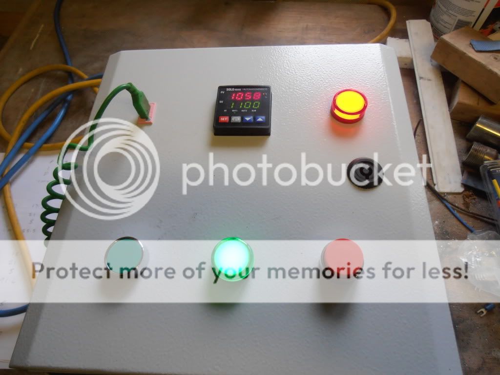

The green cable on the left?
That's the thermocouple connection.
It should actually be pink to match the socket, for a type N thermocouple.
I use plugs and sockets for all the connections; mains in (as usual), power to the elements, the thermocouple and the door-switch circuit.
The photo was taken when using the control box to test-run a 42" sword oven I'd built. I'd had to add a second (slave) circuit to the control box to run the second element; It's a 6kW oven and UK mains outlets are 230V, 13A, so I needed to use 2. The second circuit is in the yellow cable, just what I had at the time. I used a green type K extension cable on the thermocouple because it was what I had and it let me put the box on the bench, with the oven on the floor, for comfort. The cable on the thermocouple itself is only 1M long.
The control box will still run the smaller oven.
Having everything just plug in makes it easy to play with. If using a Ramp/Soak controller, the controls can make up around half the cost of building an 18" HT oven, so the plug arrangement effectively halves the cost of a second one and makes separate ovens for hardening and tempering affordable.

Only problem I see with using one single channel controller with multiple devices is that it will need to be "re-taught" before each initial use. If not you run the risk of it either oscillating or over shooting temps.
If it's a multi-channel unit you can use a discrete channel for each device.
Although it's a single-channel controller, I don't find it much of a problem.
For the "odd" things, it's a case of having to manually enter the PID settings before use. It's not a problem as long as they are written down after the first autotune run, preferably on the oven/furnace/whatever.
For using heat and temper ovens, they can be made identical, which overcomes the problem, but I take care of it in the controller.
The AutomationDirect Solo controller that I use has 4 different sets of PID values and automatically uses the set that were tuned at the temperature closest to the setpoint. If I tune the controller on the tempering oven at, say, 150 degC and 350 degC, then change to the Austenitizing oven and tune at 500 degC and 900 degC, storing the PID terms in the controller, I can Austenitize my blade at 790 degC with a correctly-set-up controller, then plug in the tempering oven and temper to 230 degC, also with a correctly-set-up controller.
