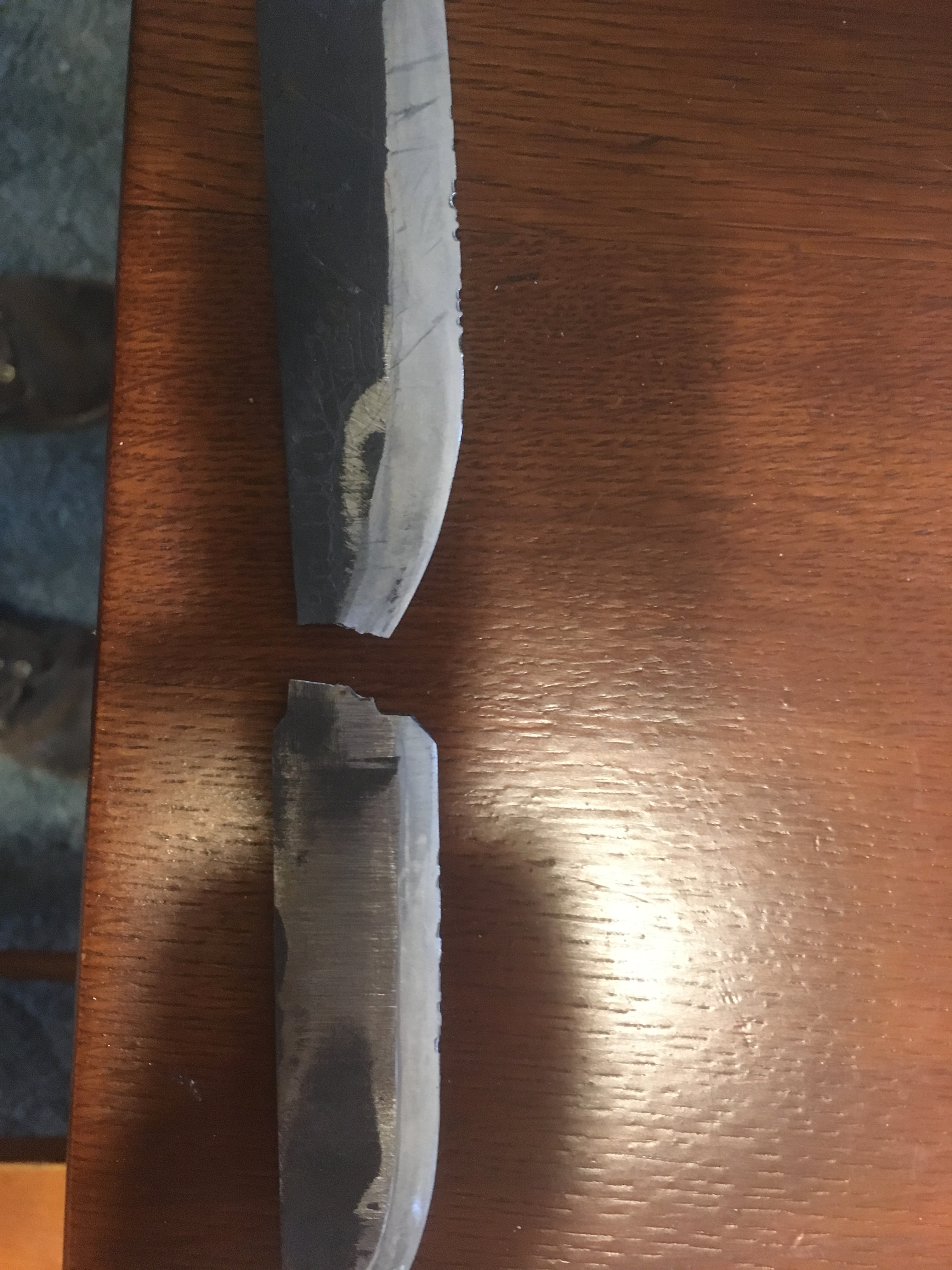

Hi Folks!
I am just getting back into blacksmithing again after a long hiatus and have decided to try my hand at knife forging. This is something that has interested me in the past though I otherwise stuck to more practical work such as hooks and the like.
Here's my question: What do people think the steel is and is there something going on in the heat treating that could be done better?
I have a pile of leaf springs which I got from my local mechanic shop. They are off some larger trucks, probable f350 or so. So I decided they might make some fine knives so I forged and ground them and then proceeded to attempt to heat treat them based on information I gleaned from the internet.
Here's what my results were. All quenches were done after I brought the steel up to nonmag in a gas forge and then put back in forge for a few more seconds and rotated regularly to make sure the heat was even.
Water quench: Soft and cause a bend no matter what. I didn't have much hope for this quach but since it was a unknown steel I figured I should try all the method to see what was the best.
Gear Oil Quench: Harder but not file skating hard, the oil was a very dirty so maybe not a useful testing medium.
Vegetable Oil: Prewarmed to the point of too hot to touch for long. then I quenched, this was a similar result to the gear oil.
Air Hardening: This seems to have made them the hardest by far. After bring them up to nonmag I just let them cool and after they were handleable I tried filling them and found the file to not bite at all.
I have at this point 3 quenched in oil and 2 air. I am tempering them all to 450 in the oven and will attempt some stress testing on them after to see what the qualities of the steel are.
Any thoughts would be greatly appreciated, Thanks!

Here are my results after sharpening two knifes, one air hardened and one oil. both were tempered in an oven at 450.
Oil is bottom and right. Air is top and left. As I'm sure all of you can see the oil hardening created a much more even development of grain structure. The Oil test also held up much better to being smacked with a crescent wrench, though that somewhat more difficult to see in the pictures.
I also did a edge retention test and while the air hardened knife held up okay the oil was better.
The test consisted of hanging a piece of bailing twine and cutting it 5 time in the air to which both knifes did great immediately after sharpening. I then smacked both knifes on the end grain of a price of oak for about 2 minutes. I then repeated the string cutting test and while the oil knife still cut just fine the air knife cut twice but failed to cut with three of the slashes. it also send the sting flying a lot more, even when it did cut.
So my conclusion is that this is a oil hardening steel and after more research I image that I can perform much better with some heat cycling and some better soak times at hardening temp. I hope that I haven't wasted anybodies time here with the fact that I have more or less answered my own questions but I hope that others can gain some useful information from what I am doing. Just for kicks If people are interested I can continue to to post my future testing of knife making from this same spring. Too bad I don't know that make and model of the truck, maybe I can find that out.

BTW, the grain is set in the austenitizing, not the quench. It doesn't matter what quenchant you use, the grain is the same if the steel was heated to austenitization the same. Overheating grows grain.
