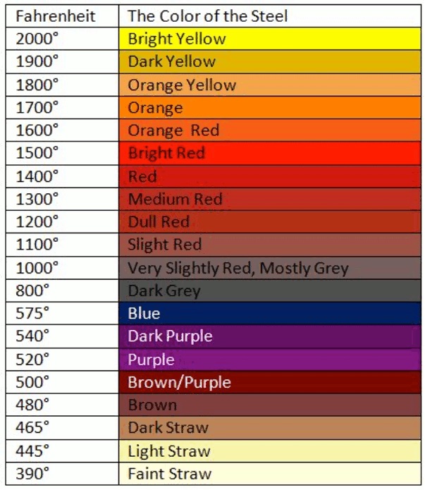

How does one effectively manage a heat treat with just a forge, or just a torch? Either 1/2 brick or torch. When I look up specific steel specs, it will say something like xxxx degrees, soak 5 minutes, quench (in one medium or another). Then temper at xxx degrees for 2 hours. Usually giving different temperatures for different rockwell scores.
The usual tutorial will speak of a magnet and the piece losing its attraction to the magnet. However, does that mean it has reached the austenitizing point that it would after obtaining said temperature and soaking? Or does that mean it has just reached the temperature, and now needs to be soaked for 5 minutes?

Heat treating in a forge requires a lot of practice. The diagram I posted shows the color variations of steel as it’s heated up. Keep in mind that heat treating some simple carbon steels in a forge can be done, but you are better off selecting steels with a more forgiving temperature range.
I think the lower part of the diagram (575 F and lower) is more showing the temper colors that will show up on shiny steel like Bradley talks about here:
Then we shined it up with steel wool, and heated the base of the chisel until we saw "straw" color at the edge
And once you got that color (indicating that the steel is around 450F) you probably immediately dunked the chisel in water to prevent it from getting any hotter and turning brown/purple.
