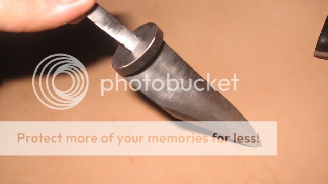

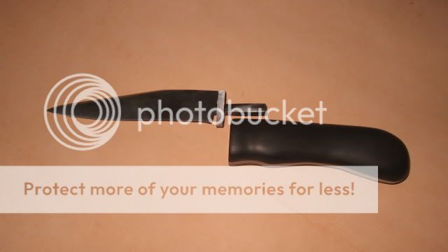

I think I will go with the charcoal forge. I don't want to mess this blade up, but I want to finish it for this weekend. I need to finish the heat treat so I can solder on the bolster. I don't have access to oxy acety, wish I did though. I will try with a simple charcoal forge for this one, and I am looking at building a gas forge and a charcoal one (little better than the one I will use for this one). I did a search on forge building and they are relatively inexpensive and easy to make. May take a little time that's all. I really like making knives, even though it has taken me so long to do this first one.
that is a really interesting shape especially for a first blade, not bad, just different (i do like).
that are those, rose wood handles?

Just a comment, but the tang should be at least twice as long as it is on that blade. You can weld on an extension with a MIG welder easily if you have access to one.
The reason that it is too short is that it may split the handle when cutting down hard on something. The blade is about four times the length of the tang ,so the force at the end of the tang is four times as great. Epoxy it in well and it should be OK for a first knife. Make the next one longer.

The handle is black african wood and teflonin the middle. Yes, the tang is very short. I need a longer bit to go into the handle more. I do not have access to a welder, wish I did. I destroyed the ricasso on this blade, learned a lot on this one. Still a lot more to learn though.
for extra strength you may want to consider drilling small holes in the bolster on the handle side for epoxy rivets. Just a thought. You don't need to weld it, silver solder if you can though.
Interesting choice of teflon. Did you select that for any specific reason or did you just have it available? Nice work.
