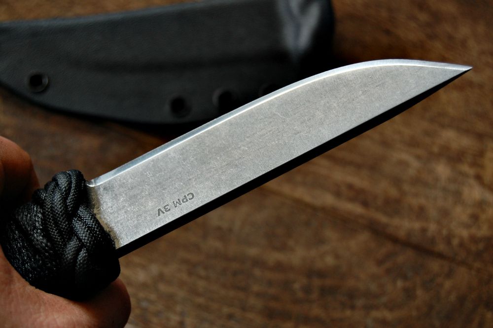

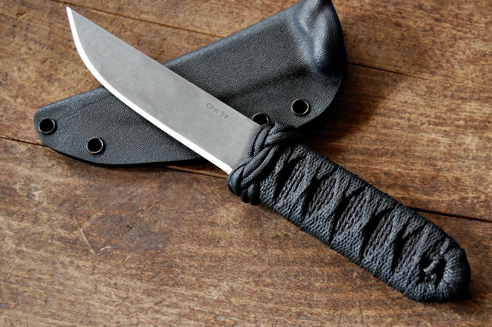

Just finished this one up, hope y'all dig it
Specs:
1/4" thick CPM-3V
Peters heat treat, double temper & cryo at 60 Rockwell
4.5" blade and 9" OAL
Flat chisel grind with reverse edge bevel
Handle is cord wrapped and saturated in fiberglass resin.
Acid etched & stonewashed finish
Thanks for looking at my work!
-Joe
Looks great!
Do you mind giving a bit more info on the finish?
What grit did you take it to on the grinder?
What did you etch with?
Etc.?
Thanks
Nice work, it looks tough as nails.
I have to come by your shop since you are near Austin. Just to buy you a beer and to see some of your work in person. I really like his one.
Thanks everyone for the comments!
For acid I typically use ferric chloride.
