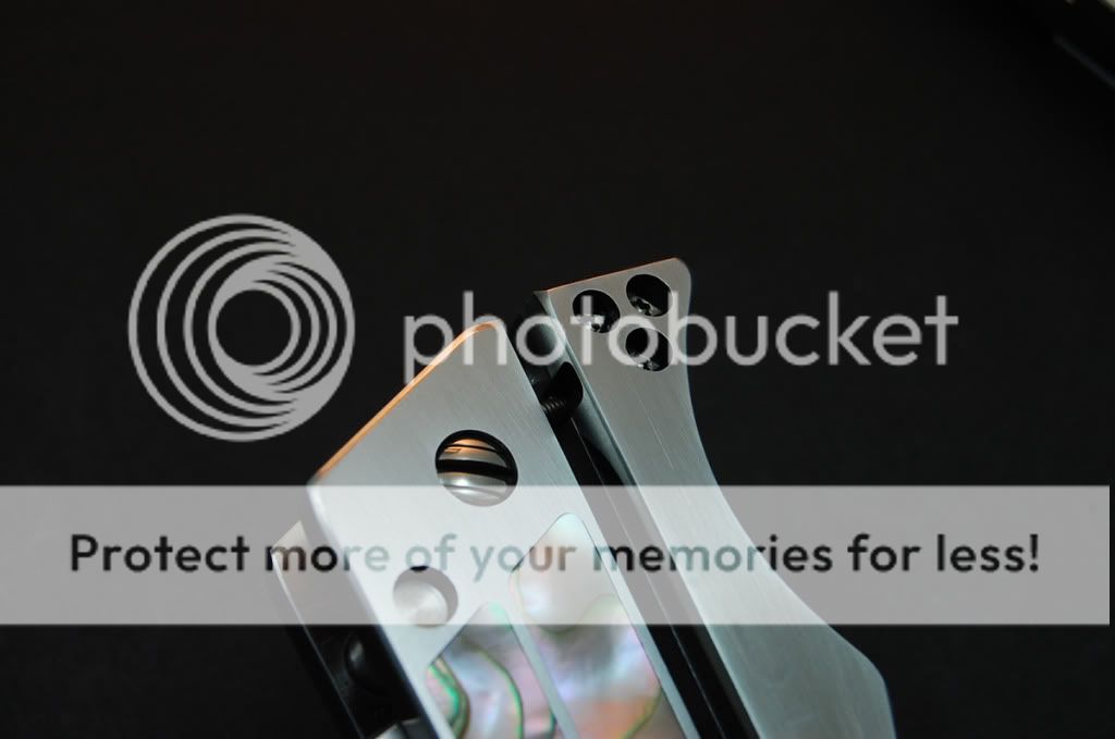

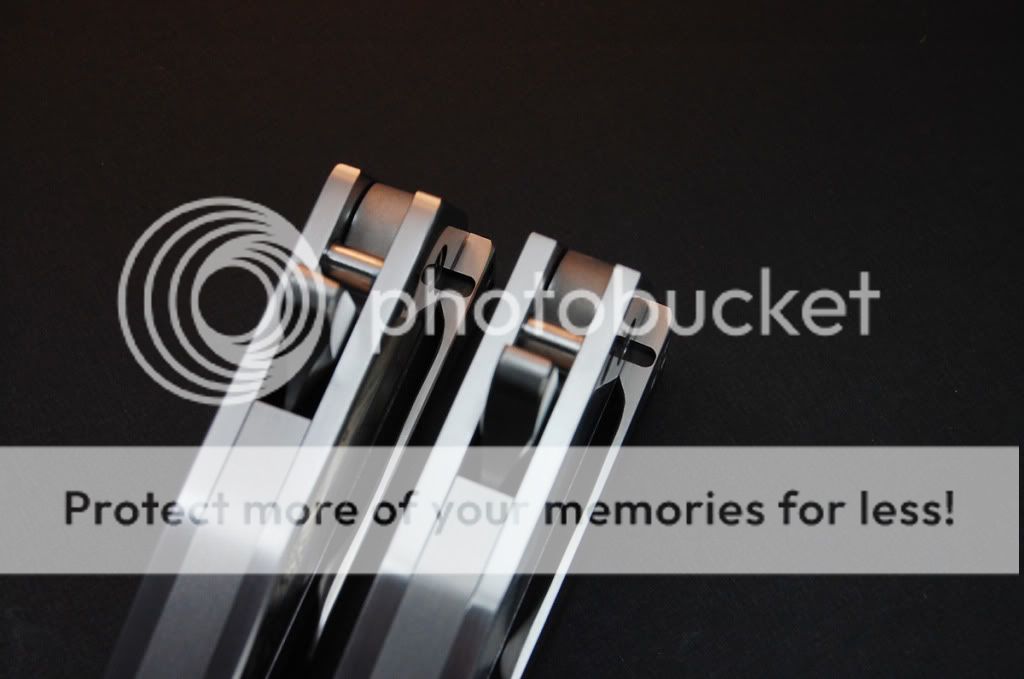

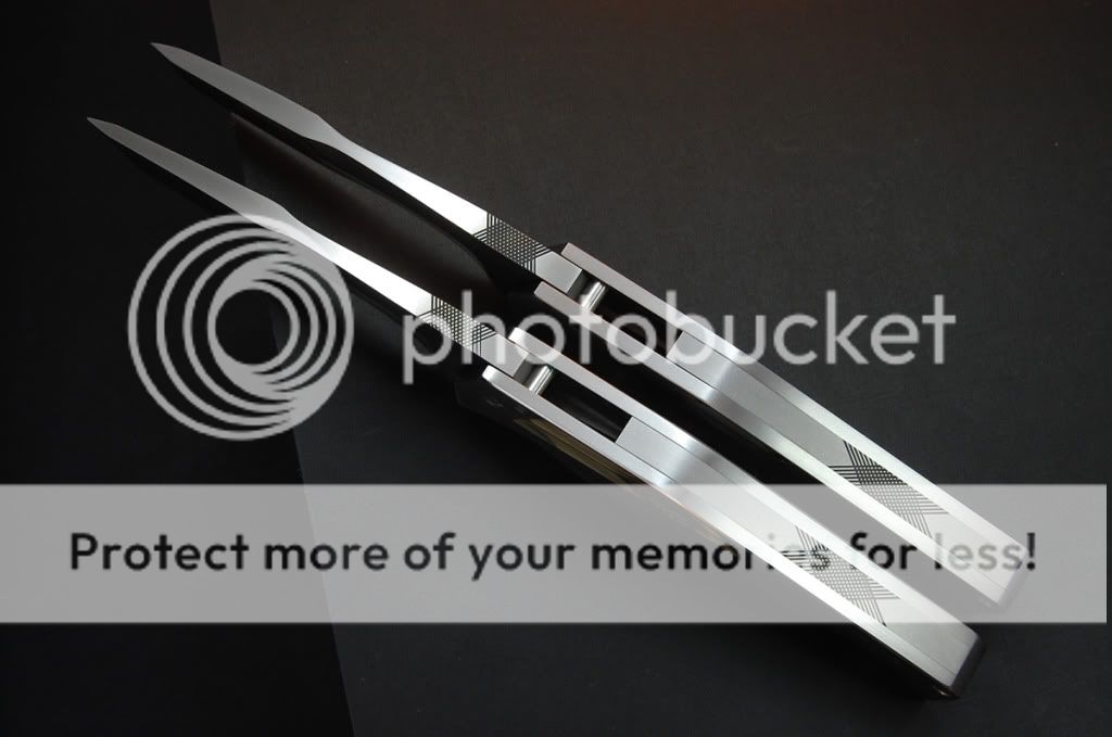

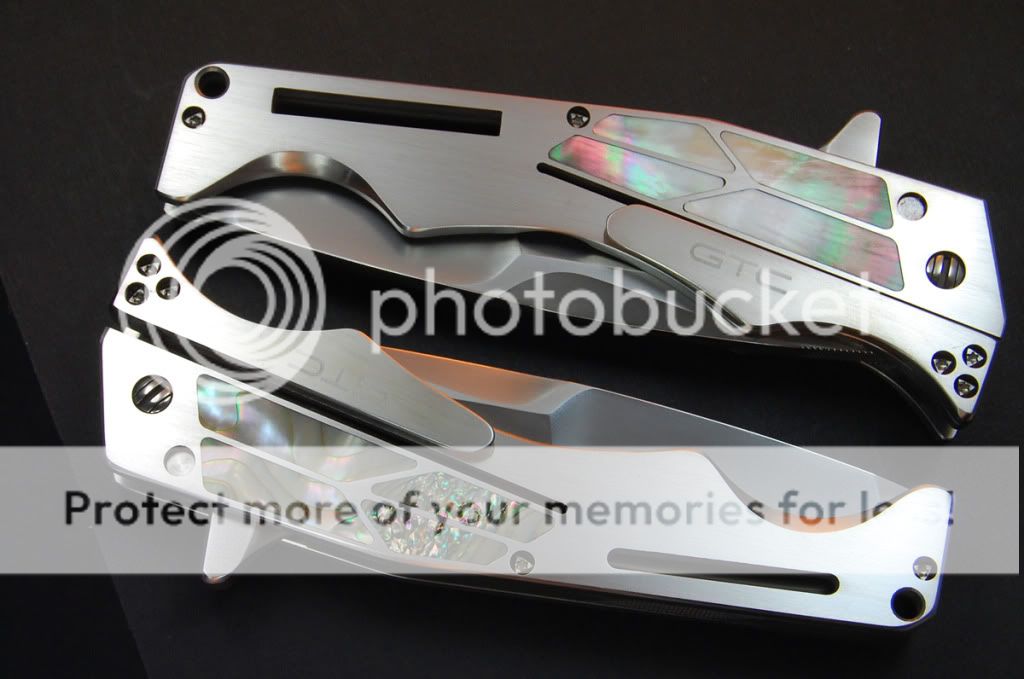

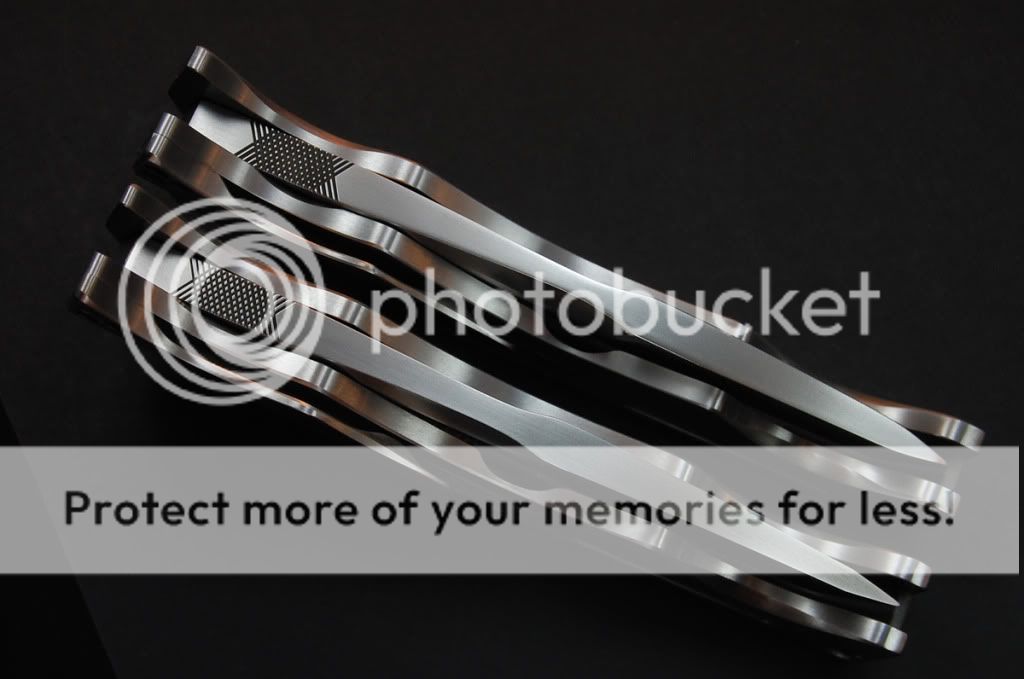

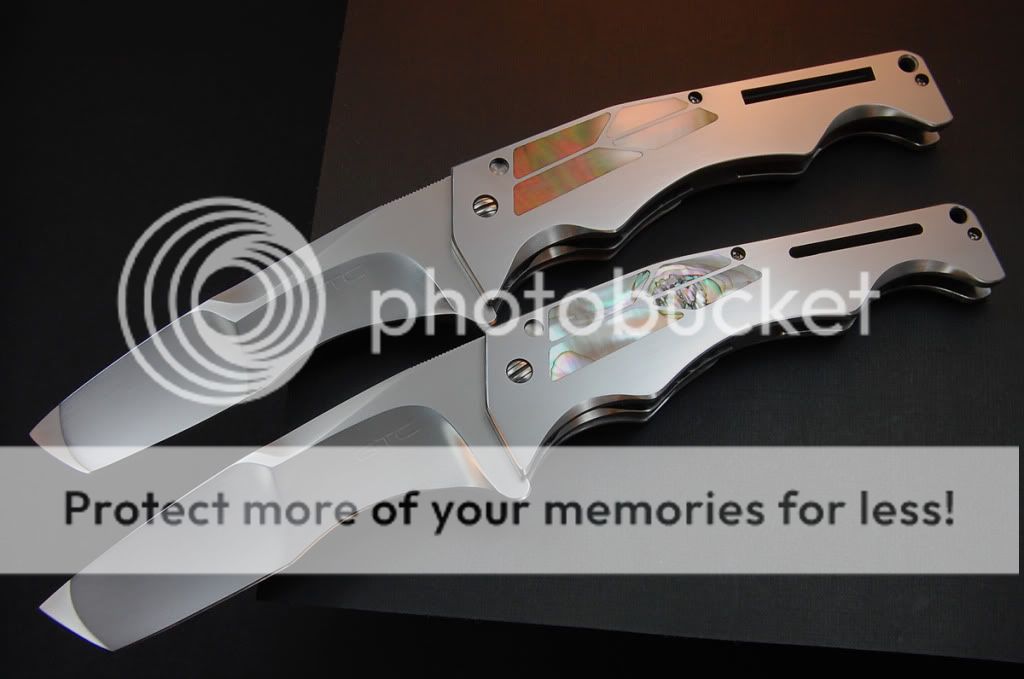

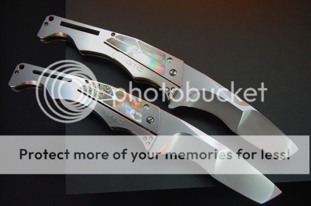

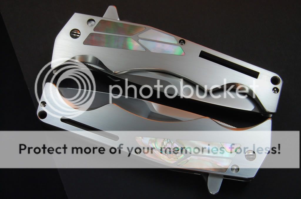

Just finished this .50 Cal pair, the order was 5/32" SS frame (first ones I made without titanium frame), abalone inlays in one, blacklip in the other, 7mm thick RWL34 blade, so yes, they are heavy! I also changed the lockbar limit screw position and the way I did it, now the lock is limited either for not locking to far (happens occasionally on heavy chopping) and unlocking due to the front framelock clip/lockbar attachment design. Thanks for checking it!
triple WOW!!
beautiful Gustavo,
they make average tactical knives seem mundane....
dan favano
Nice "choppers" :D, the grinds on those are pretty wild.
