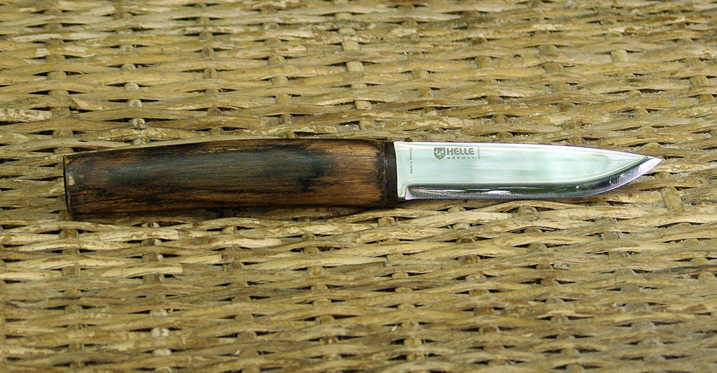

Yeah , that's not a blade blank anymore !
It came , I saw ... I 3D printed , sawed / drilled & glued !
And here we are ..
Lots & lots of sanding to look forward to .
Looks like I snagged the last Helle blade Nordic had .. Prices are going up !
But when you take a finished knife into consideration , a bit of DIY can save you some $ .
Oh dear ! Finished gripping the Helle .. Unfortunately just in time for sunset ! No pix ...
Oh well . pictures on the morrow !

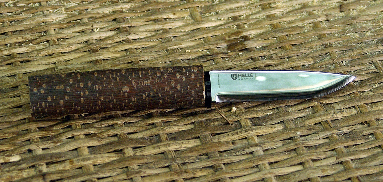

I suspect this blade to be a factory 2nd .......... Or not good enough for a factory knife so sold off as a DIY blade ..
I think so because one side is perfectly polished / finished .......... While the other side still has the grinding groves running all the way to the edge .. Polished , but the groves are still there .
And one of those groves running to the edge , might be responsible for the FAIL !
Re Sharpening !
Ok , so one side of the scandi edge is really good !
The other side is a little FUBAR .. ( Did I say this blade might have been a factory 2nd ? )
Those groves , under a 5000 grit stone , the edge feels like a saw !
Also right where the belly curves to the tip .. Is a classic scandi fubar ! The edge thickens up , call it a lump !
So all my re sharpening effort was spent removing the hump or lump from the edge . ( Did I say the other side was pretty much perfect ? )
So right where the hump was ( or lump ) , the edge is very nice and no grinding groves remain ..
Some of those groves are very deeply engraved , so might take years of use ( decades for me ) to sharpen away . ( Straight part of the belly )
