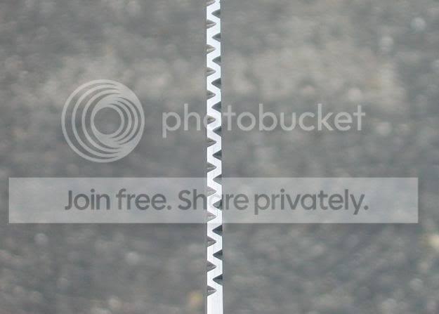

It has some file working on the part of the spine which lies flush within the handle.

And, not intending to be too critical, a comment regarding the filework. If the cut grooves aren't evenly spaced, don't match each other, or are jagged it just looks 'off'.
Here's an example, a random photo found online. Nothing fancy, but notice how every filed groove is the same size and shape, and evenly spaced. I can't even imagine how long that must take...
Anyhoo... Welcome to BladeForums, and I'm anxious to see more of your work.
Hey guys thanks for the feedback, we do have other handles in the works as many of you have talked about. Our fit/finish will most be better on the next one.
We weren't super obsessed with perfect finish on this one, as it is less difficult than making the knife shaped correctly to begin with, (grinding is much more time consuming)

Bob W. Hey thanks for the compliments, we enjoyed working with the circular saw steel, MAN DOES IT GET SHARP with a convex edge, 1095 should be great to... We also like the hardwood handles, just something about them. The funny thing is, we have one prototype that looks almost exactly like what you posted, this one just wasn't meant to look perfectly symmetrical, it was meant to look more different, our file working on our next project actually looks very different, and is more of a symmetrical design.
