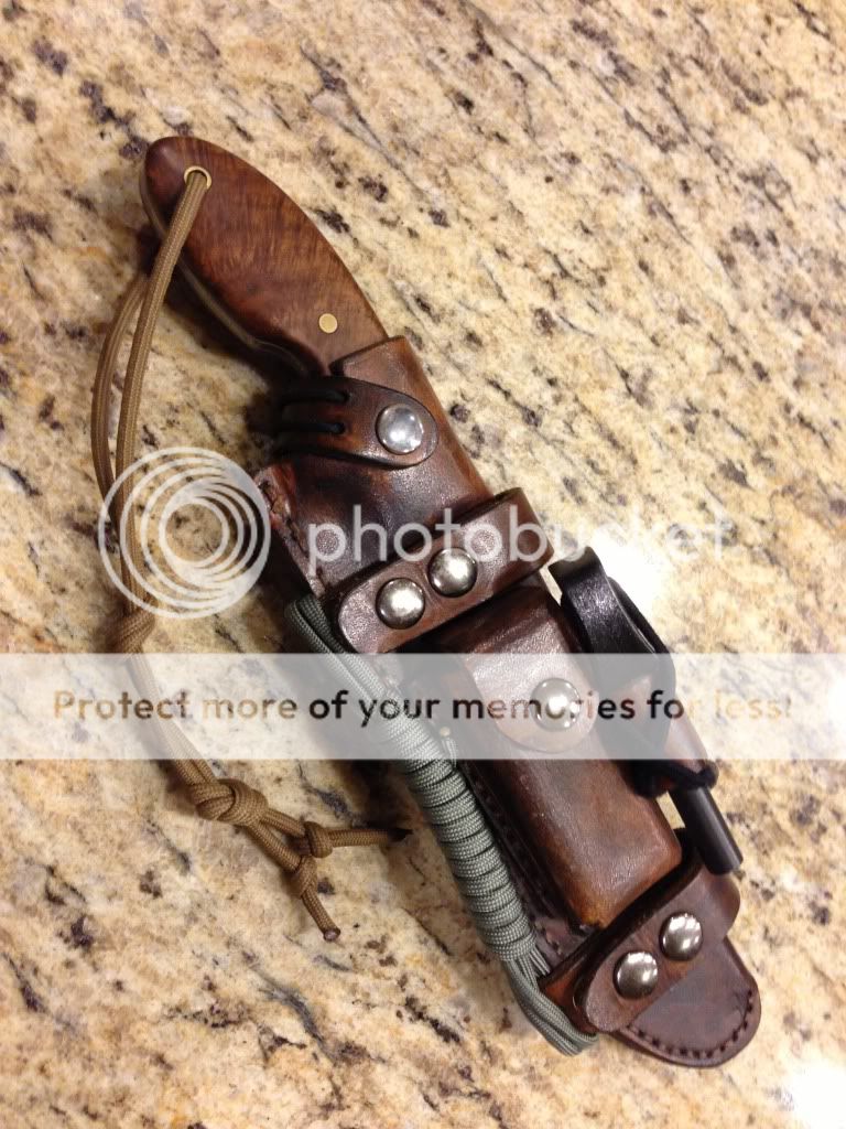

Two question for you guys. Is it enough to just back stitch to hold the stitches together at the end? I get paranoid and tie a knot at the end, then put a dab of super glue on it. I think it might be overkill. Secondly, what do you guys do about buttons rubbing on the knife blade or handle? I've been putting a tiny piece of gorilla tape over the back of snap buttons. This has worked to stop un-necessary scratching from the button, but I'm thinking their might be a better way. Just wanted to get this forum's thoughts on this.

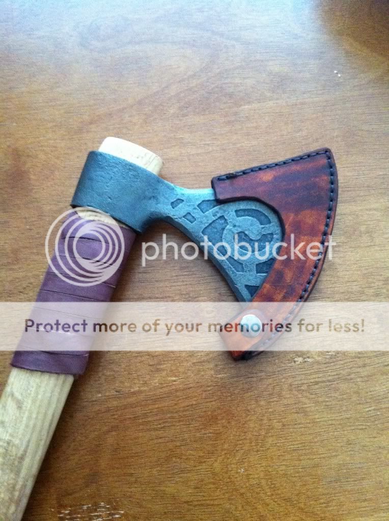

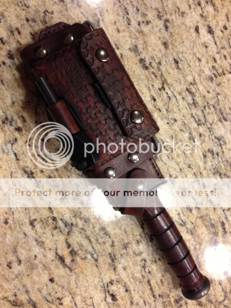

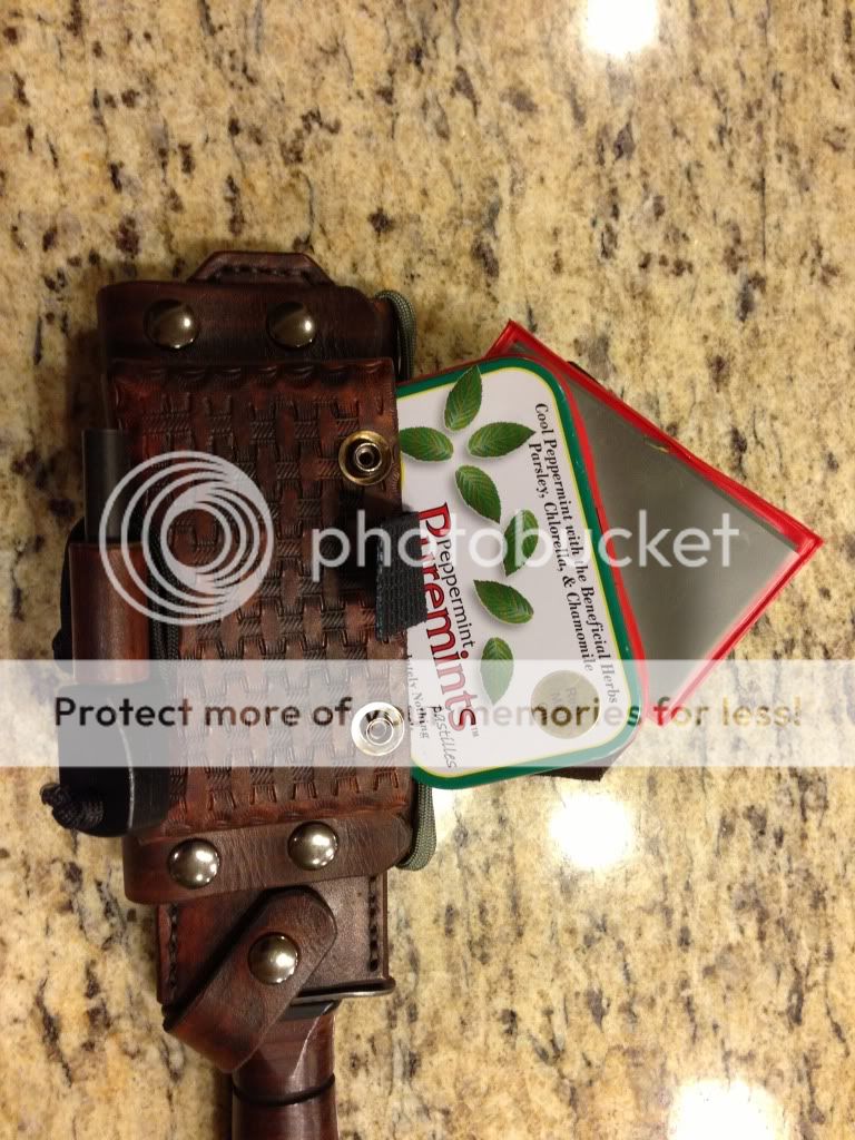

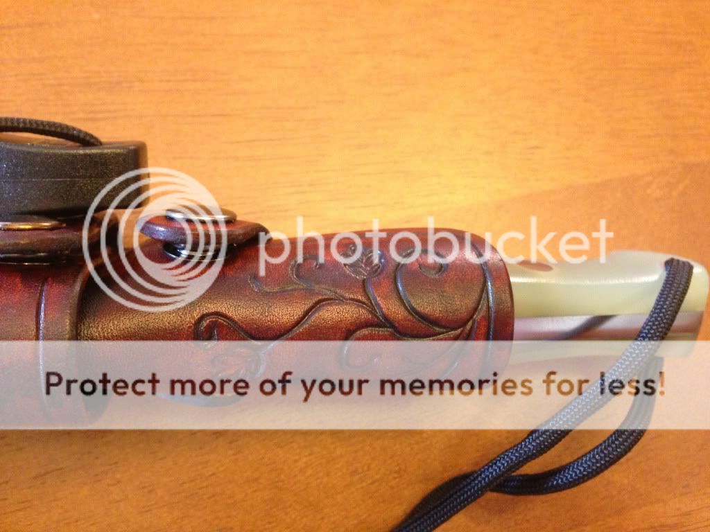

Here are the 4 sheaths I've made so far in the order I've made them. I learned to etched the cold steel norse hawk by reading the blade forums as well. Once again thanks to all on this forum for the info you guys bring. It's a wealth of knowledge here. The last sheath with the vine work I just finished last week. I'm trying to practice carving on pieces of leather I have around. I also bought a few stamps.
Those are your first efforts? Wow. Here I was trying to figure out how to make a couple of super simple slip sheaths with one piece of leather and some thread. Nice work!
