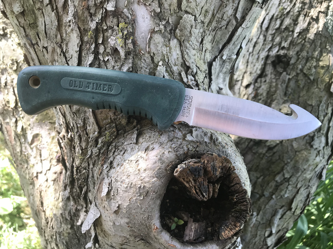

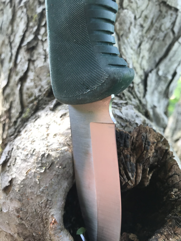

It’s a quick way to mess up a decent edge if you ain’t seriously skilled. I could do it and make a satisfactory edge without walking the bit over the flats, but I won’t, because I know how easy it is to slip. I’m adept at dremels because I’ve worked with one a lot and know what I can do. A file, used deftly, is a much better choice for a large knife than a dremel, not because of overheating, but because the edge will begin to get wavy after a few sharpenings.
Here’s a choil I added to my 143 with a dremel. No slips, though I taped it up good.
