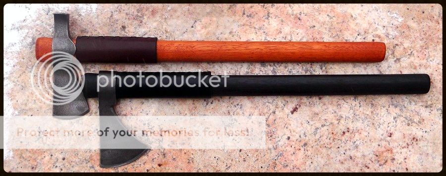

It would need to be a very light grade of leather in order to fit well on the handle, those picks can be pretty small. it might be better to sew a wrap over the handle than to expect light leather to hold a plank shape or use something too thick for your tool, like 10oz. leather
Maybe a scaled down version of an overstrike wrap on a tomahawk. Just my thought on it.
