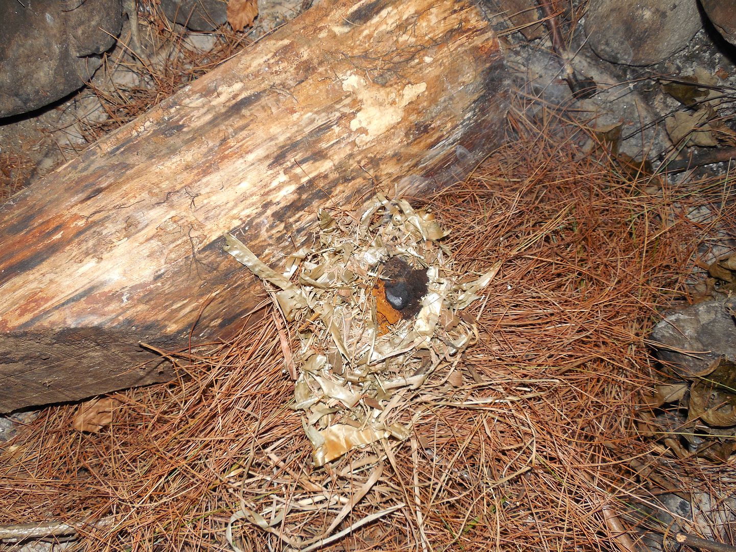

Hickory plus some unknown dry fluffed bark plus punk wood.

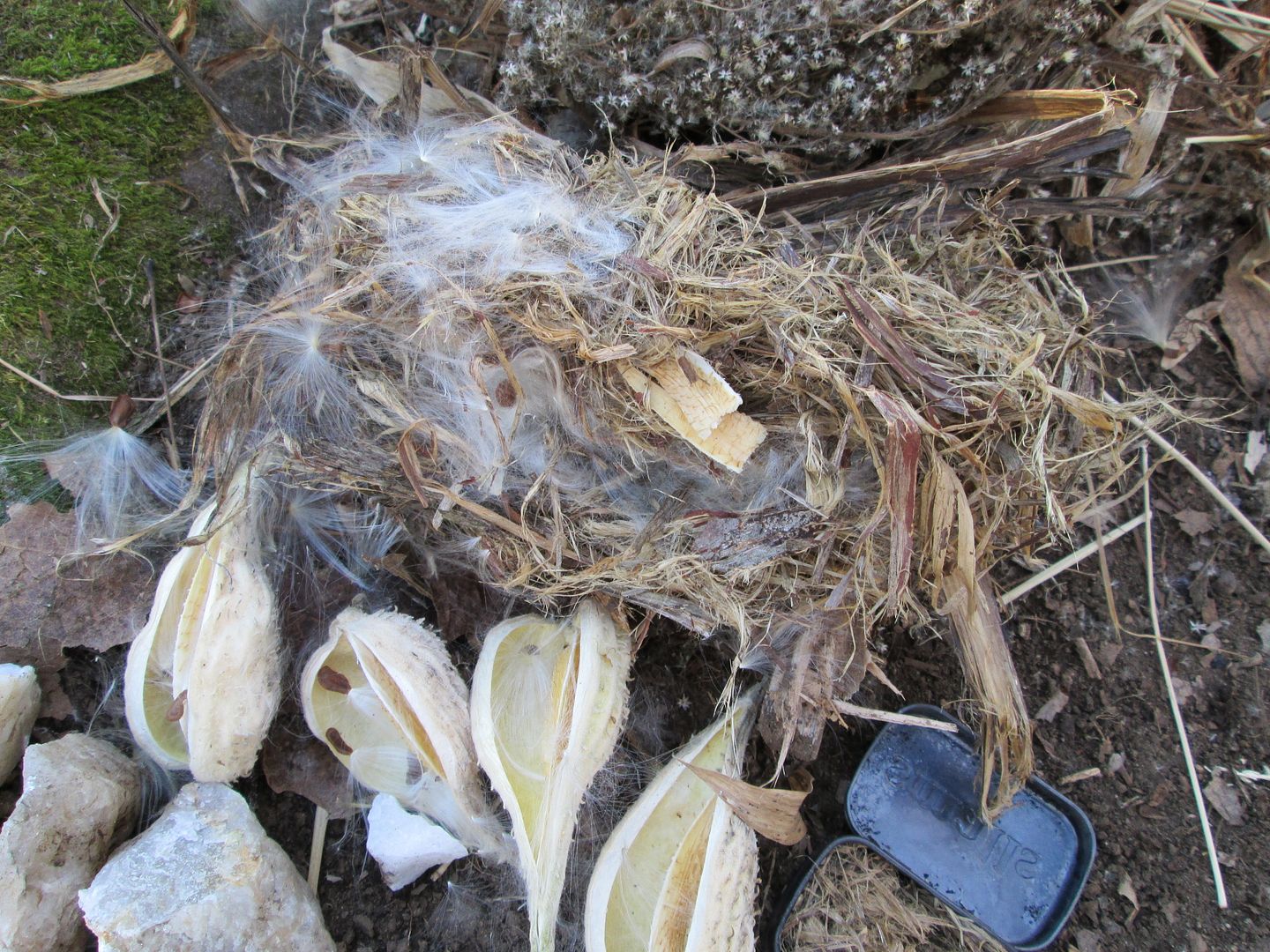

Cedar bark with a bit of milk weed ovum fluff.

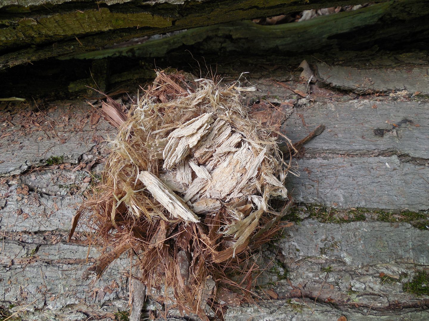

Dry grass, yellow birch bark and some cedar bark. Chaga coal.
