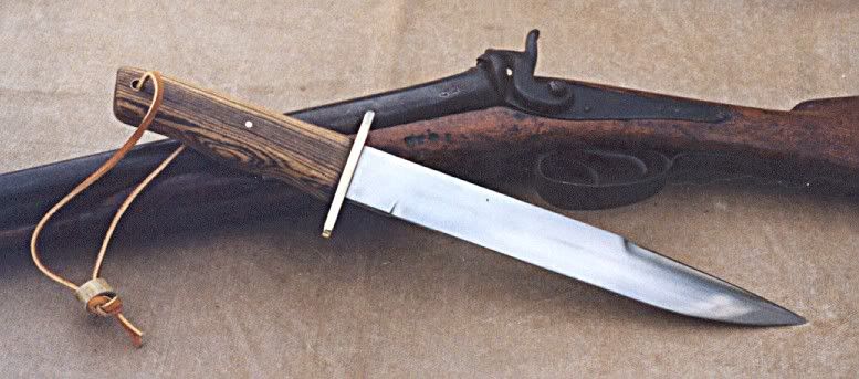

Here is mine :)
You have to go Bowie that big which is too heavy. If you want a pig sticker you'll have to go about 8 inch. The CS OSS is an excellent pig sticker and has a sub-hilt to pull it out. It is nice and light and razor sharp. It has a nice price and if you want to go more the CS Black Bear is better steel but heavier.
My nephew is a county hog trapper in Citrus County and hunts hogs with a knife in his freetime. He designed this one which I made for him.The spec's are 9.5" blade,1.25" wide,.187" thick O-1 .He has killed quite a few with this one. He and I both feel a narrower blade is better. Good luck with your hunt.Dave

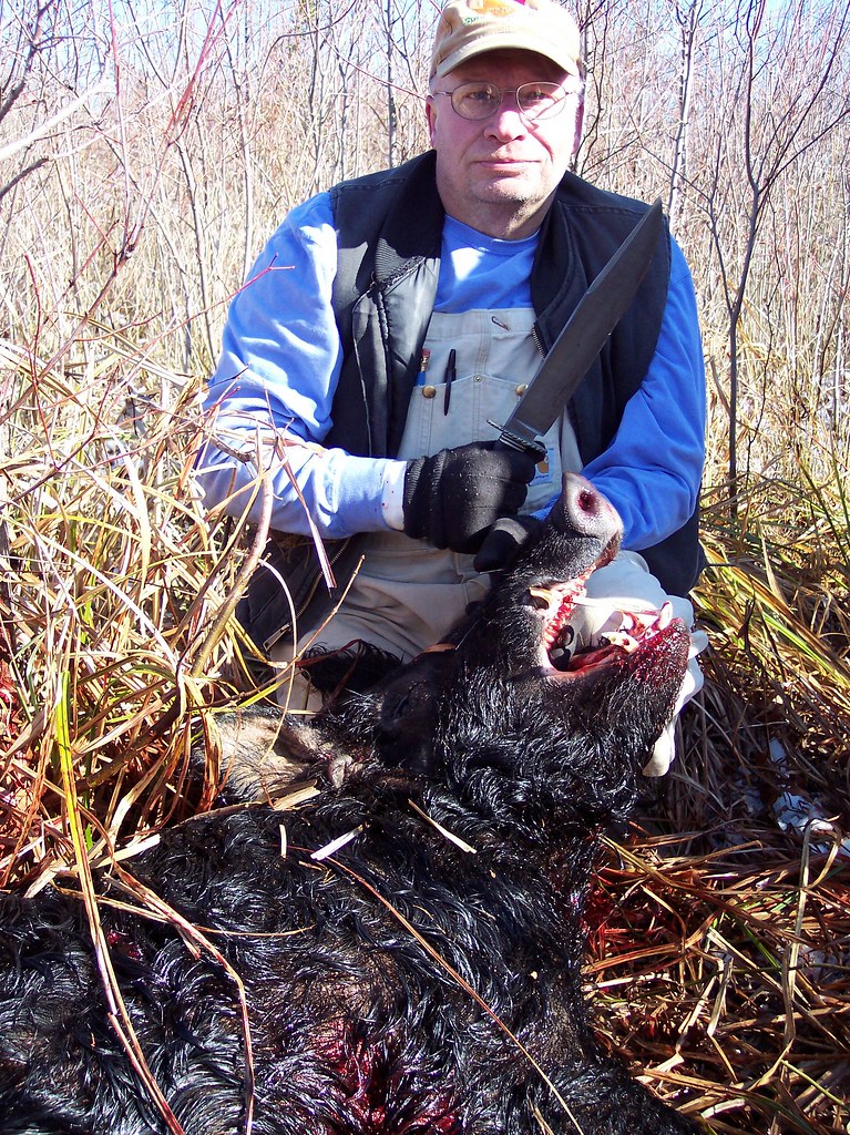

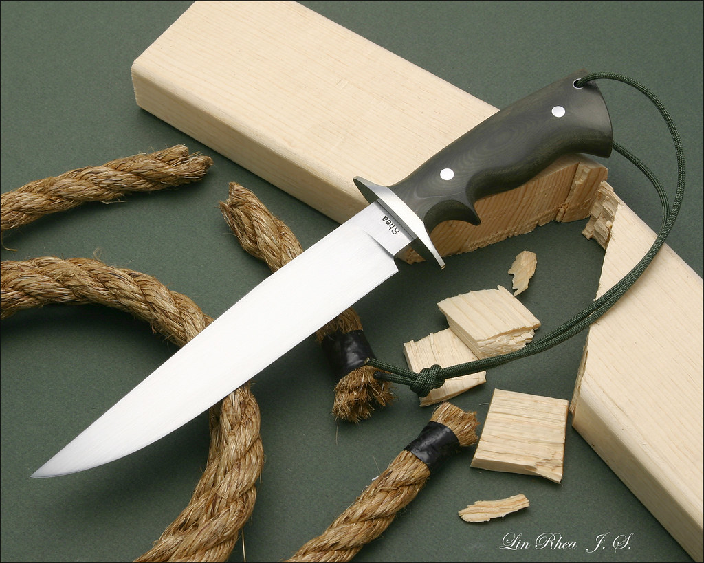

I make this subhilt with an 8 inch blade. The top clip is sharpened enough to help with penetration, but not enough to cut you if you just were handling it. It could be angled more for more cutting ability. I use this style knife for cutting demos and hard use and think it would make a good hog knife. I killed a large boar with another of my knives, but it hade an 11 inch blade.
Here is the boar and the knife
Have fun and be careful! Lin:)
