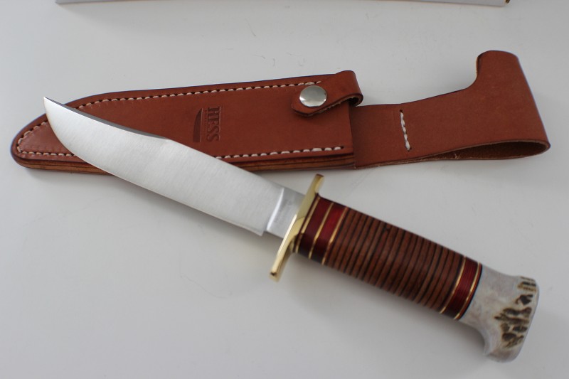

Might be a bit smaller than you want at 4.5" but take a look at the Hess Knifeworks Outdoorsman. They also make the Frontiersman which might be a bit harder to find; 6 7/8" blade in 1095, various traditional handle materials and made in the US. A huge bargain at under $150.
fq55, thats a great looking blade! Ive always been in love with the WWII - Vietnam style knives, and from my experience,knives like that are real users, Id love to get a Mark 1 some time from Ka Bar, but Im afraid I couldn't justify the purchase, I so many I don't use now!

And sure, I guess if someone really wanted to arrest me as a crazed knife killer, they could, but I figure a KA-BAR would certainly look bad to the jury, compared to that knife pictured above (which is quite gorgeous, gotta say).
