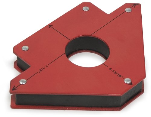

To flatten tangs i use a magnet from any knife supply place and hold it vertically to the platen. I've also used some gorilla tape to make little "tags" to hold onto. Gives some more control.

I have a "pyro-ceramic" face on my belt-grinder's platen and I love it. I hold my workpiece with a welding magnet when flattening/tapering. I start with a dull 50 or 60 grit belt to start the "bevel" and knock most of the mill scale off. That stuff will knock the crisp edges clean off a new belt. Whenever possible, spend a couple extra bucks and have your barstock precision-ground, it will pay for itself in time and belts.

Use one of these to hold the blade against the platen:
Simple and safe.
The magnet trick makes for a pretty decent "home made surface grinder" effect. With that said, if you are using steel like ATS 34, why not just buy precision ground stock and you will be halfway there?
