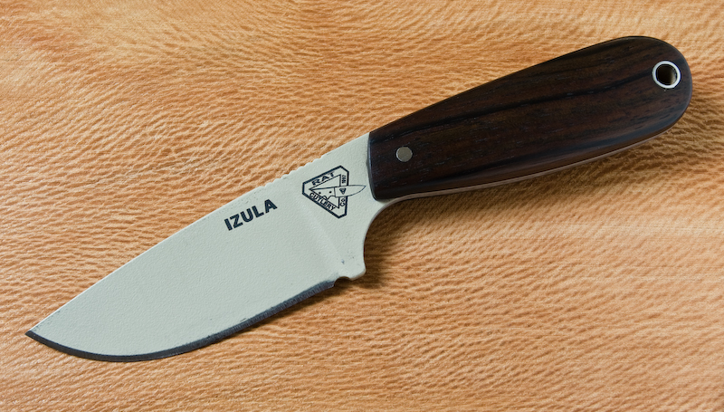

Here's a knife I did up in Asian ebony:
With a thin-kerf saw, you shouldn't have much trouble getting three or four handle sets from each piece. Most of my fixed-blade blanks are just under 1" thick. The length will be the biggest problem. Four-and-a-half inches is a little short for many knives.
