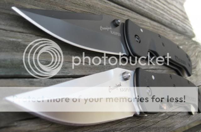

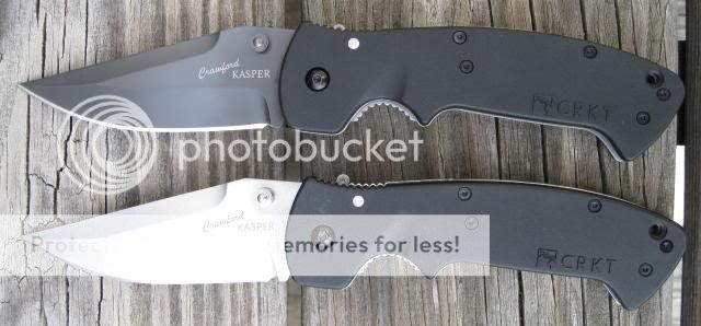

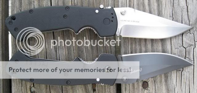

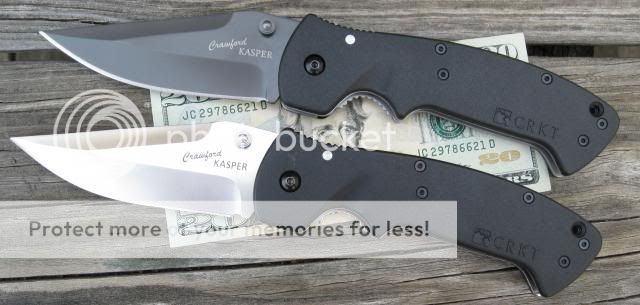

Hey guys. I'm new to the forum, not knives per se. But I am decidedly from the "old school" when it comes to knives. I'm just about 6 months into the "new school" of knives and catching up, discovering the BK2, the Sebenzas, the super steels, micarta, and Spydercos and am only now starting to warm to the looks of any Spyderco. I know, blasphemy to some probably. I want a Para 2, or a Manix 2 eventually. I have several clone knives and have spent a lot of time cramming, researching, studying into the wee hours. I've watched a hundred or so knife reviews and bought a couple dozen knives over the past 3-4 months, mostly on the budget end of things. But first things first. I've been studying the modding aspects of knives, and have a question about one in particular; the CRKT Crawford Kasper. I got the satin finish blade this time.
So with the above background in mind, I'm looking for some suggestions on either stippling or changing to micarta scales on a CRKT Crawford Kasper. I know, I know. Many of you may look down your nose at this folder, but I really like it so be gentle with the noob. ;) I think it's a great value for $22. Great blade and design. The Zytel scales are its weak point IMO. They're plastic for one thing, but the smooth surface and lack of purchase are what bother me most. If I could do a competent stippling job in the right areas and slightly round the edges in a couple of areas I think I could end up with a great feeling knife, that I could rotate the blade out in one continuous sweep, without having to readjust the hold and choke up again during the deployment.
On the other hand, some black and gray micarta scales would look AND feel good, again, assuming I could do a competent forming/shaping/sanding job after fitting and drilling the screw holes. I have woodworking and mechanic/machining experience, so I think I could handle it. Just fishing for clues from anyone who knows this knife. I have read of some having difficulties getting the knife apart due to the embedded bushings inside the aluminum spacer spinning. I wouldn't want to ruin it trying to get it apart. I've actually ordered a second one (the one with the dark gray teflon finished blade), just in case. I like it that much and it's inexpensive enough.
Any of you out there have any experience taking the Kasper apart? Problems? Tips? Pics? Any insight or details from Kasper owners would be appreciated. I believe I can make a decent looking knife even better if I can swap to a set of gray/black or gray/blue set of micarta scales. But if I need to just stipple the Zytel scales to be on the safe side, it will still be an improvement. Any suggestions, tips, advice from the knowledgeable among you will be a big help. Thanks in advance for the help! :cool:
