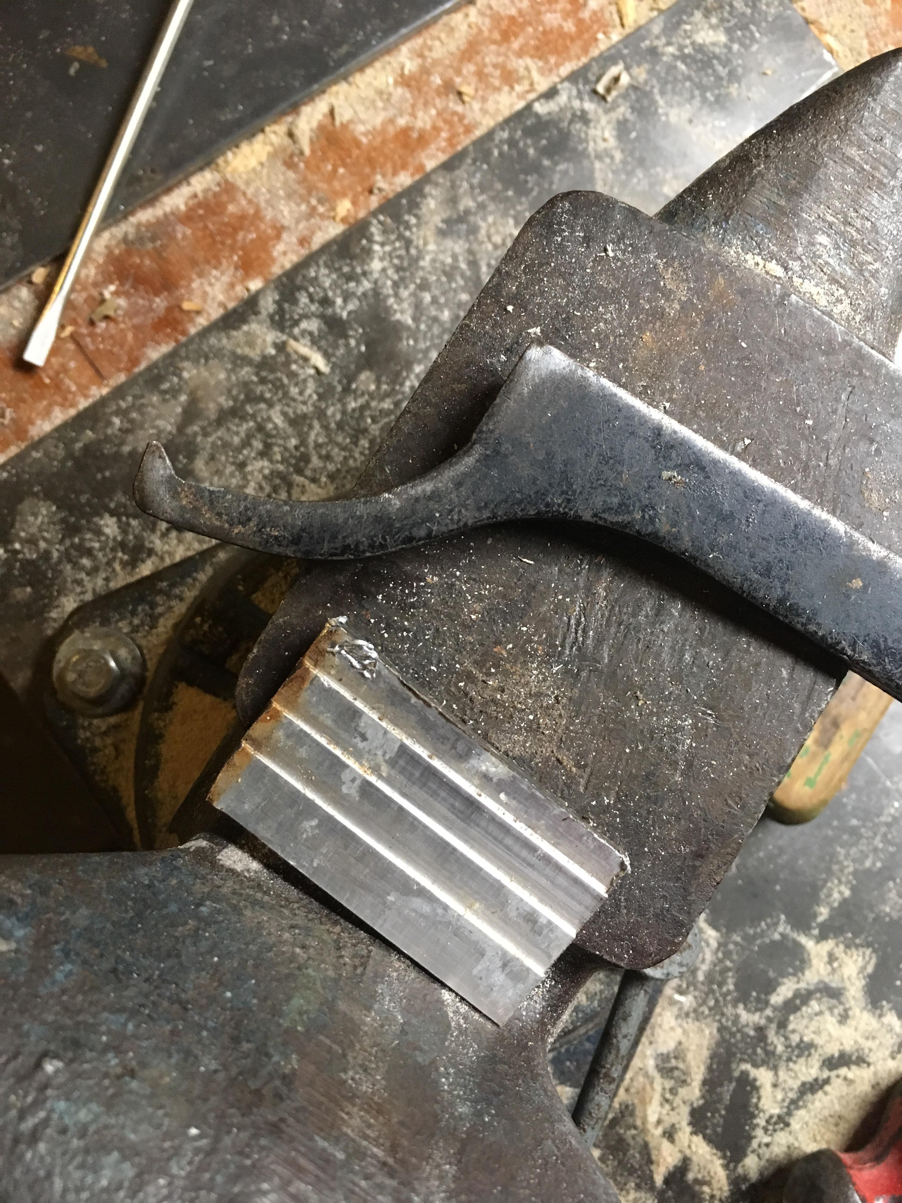

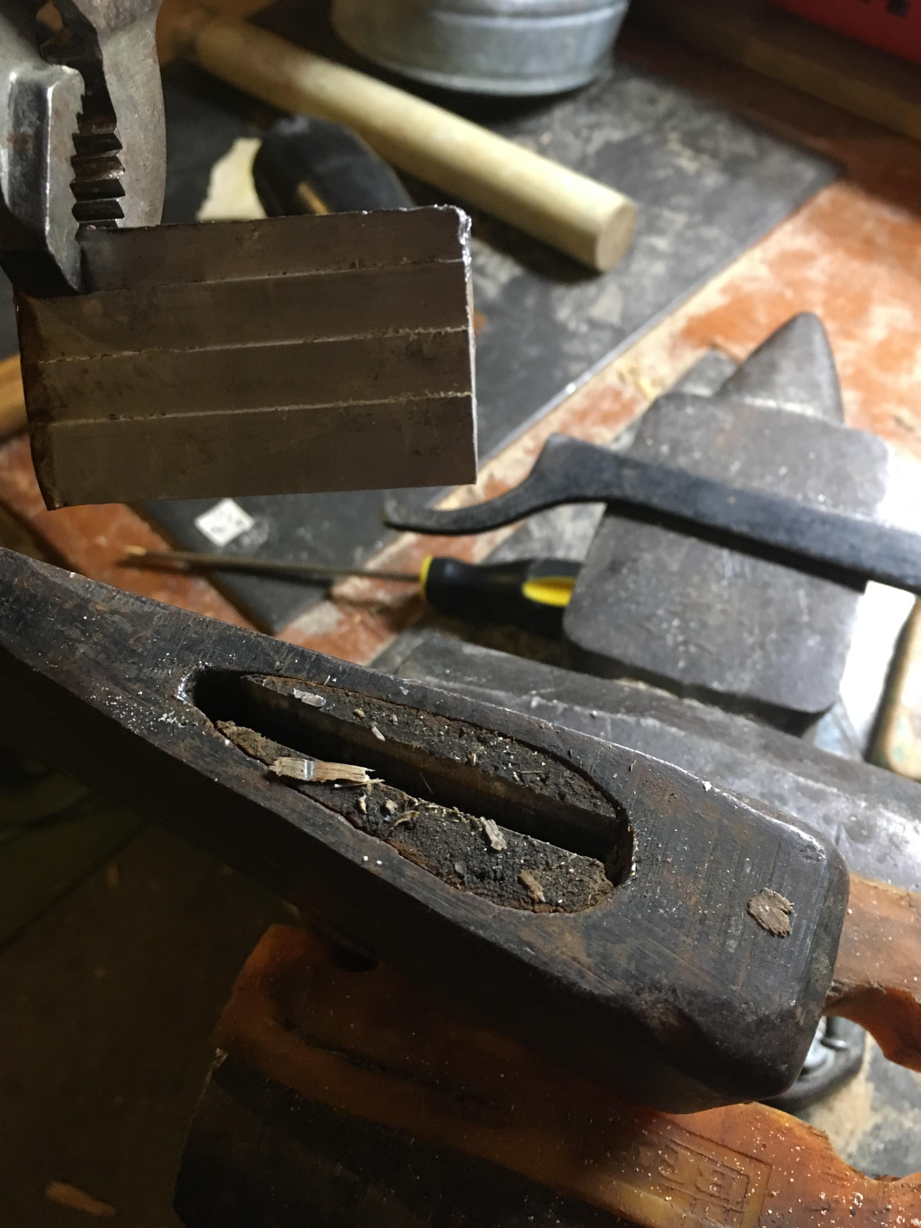

Since I'm going on about it...
That spanner thing and a junk screw driver. This wedge seems to be aluminum but same effect I think on a large steel wedge
It is about the same width as an average wooden wedge. That lets you clear out some of the wooden wedge on one or both sides of a common steel step wedge, slip it into the cleared space, and use it to pop it up and out. Probably more useful on a full size axe.
I know you can use anything to pry a wedge out. Just something else to add to the arsenal I guess.

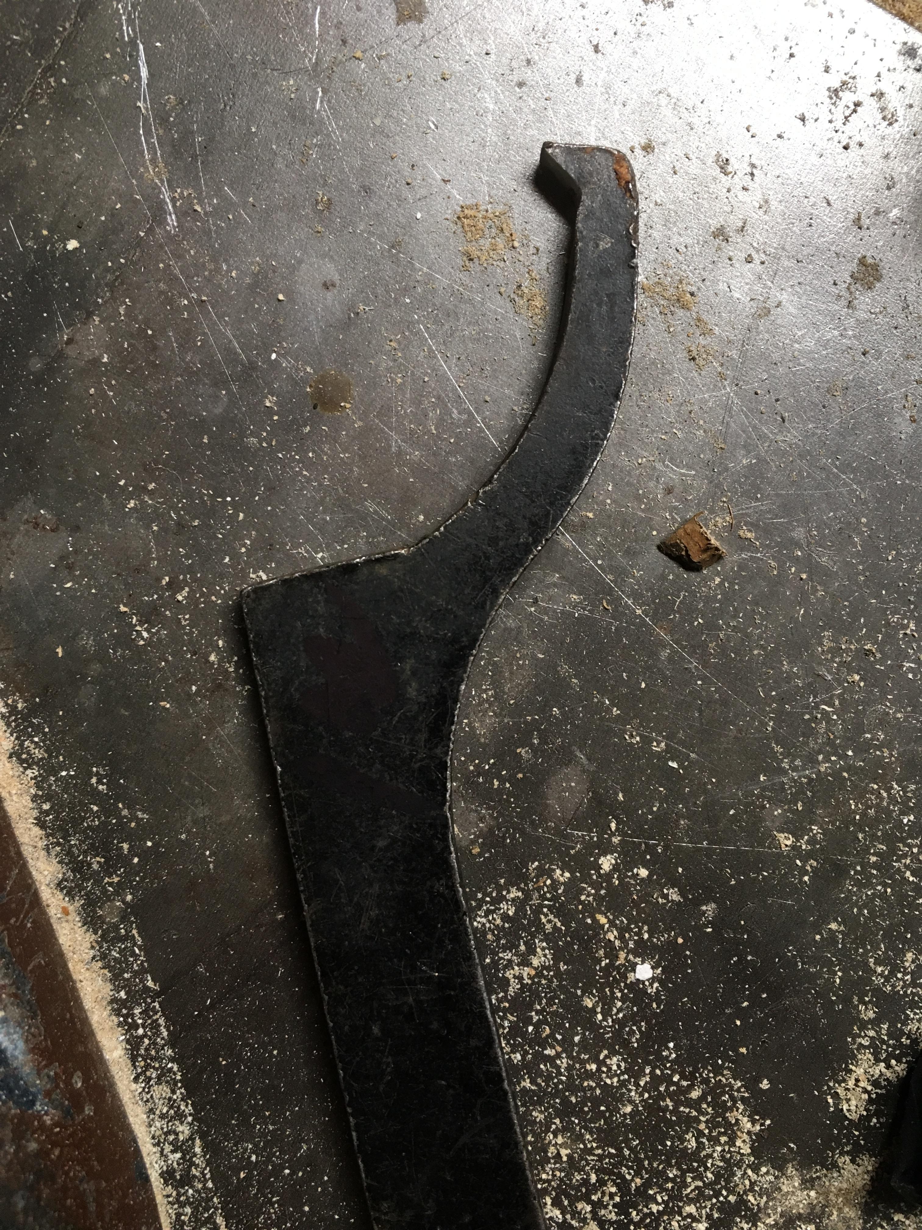

Can't find the right tool till you use it!
I like it!
When you first posted a pic of the spanner I thought maybe it's an older English bicycle bottom bracket tool...just missing a tooth.
I see it works great as a wedge pry ⚒
