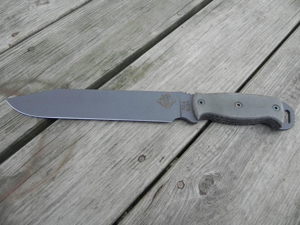

I would like to get rid of the humps on the handle of my Ontario Ranger RBS 9. What would be the easiest way to cut the 1095 carbon steel? Can I get away with using a hacksaw or do I need a bench grinder?
The humps on the top and bottom of the handle are very uncomfortable.

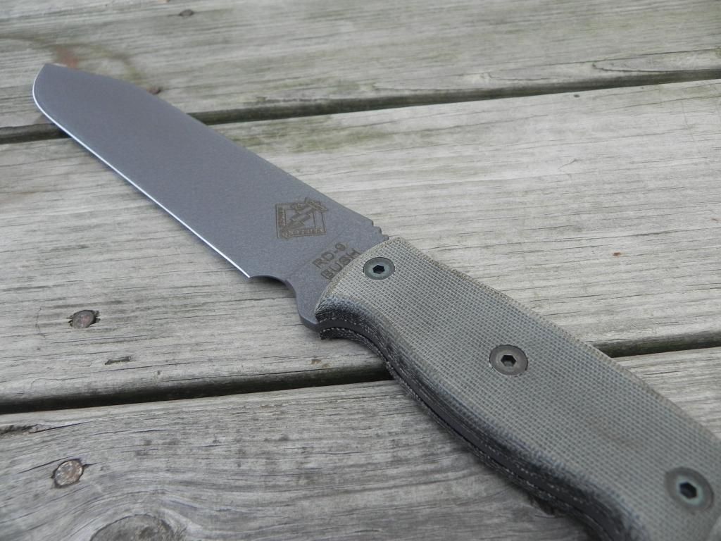

I used a belt sander on my RD 7 and RD 9. It takes very little effort.
Go nice and slow and check your grip often until you get it perfect for your hand.
Once you get the humps down you can round over the square edges and smooth it out.
I made finger grooves that are fit to my hand but I would stay away from that unless you know exactly where you want them.

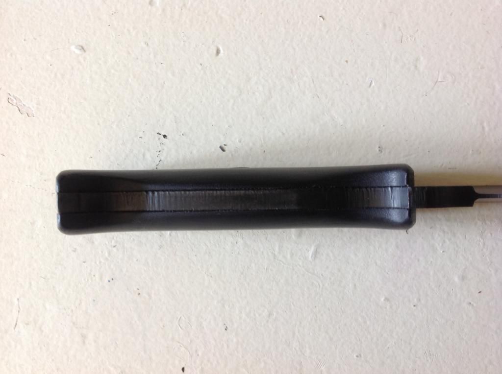

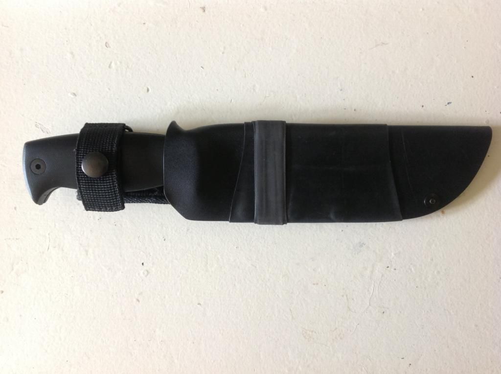

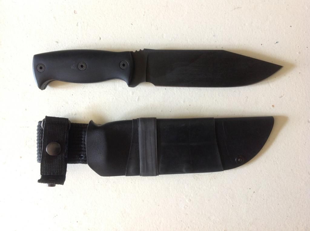

I too wanted to cut down the "belly" in the handle. Mainly for better comfort. But tried this first to make my handle more comfortable on my Ontario Ranger RD 6. Its amazing how much better my grip feels with the slabs rounded over. Threw the idea of grinding down my handle out the window. I also went ahead and parkerized it. Basically you go to Lowes and buy the ingredients to make a bomb. Then you wait for your wife to go to a work meeting and cook it all in your kitchen. Still here!... but you probably want to do it outside if you have the means. I also cut off the “bottle opener”, only because I like the way that it would look. Just used a cut off saw. Finally I made a kydex sheath. Hope my pictures show up or I’m going to look stupid….

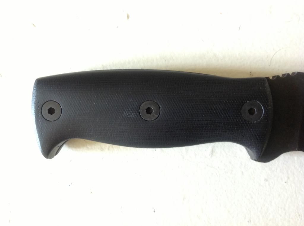

Ended up completely reshaping the handle of my Ontario Ranger RD6 to feel more like my ESEE 4 and made new micarta scales. The original scales looked and felt like they stopped a little short of the hilt. I used paper micarta and would not recommend it. I like how there are not any layers in the micarta showing but they are slick as hell. On the upside, for whatever reason, when they are wet your hand sticks to it like you are wearing a rubber glove.
