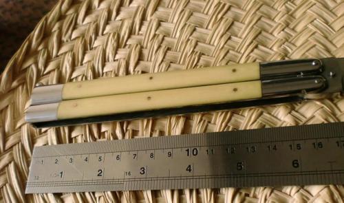

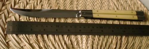

That's exactly what I do, although I also use 1200 grit paper and I don't use acetone. I use Brasso and then WD-40 after the 2000 grit. Here's an ivory micarta balisong I took to 2000 grit:

I wouldn't suggest using WD-40 and Brasso on the camel bone (just the micarta). To get the stains out, you're going to have to sand away the top layer--it can really get in there.
