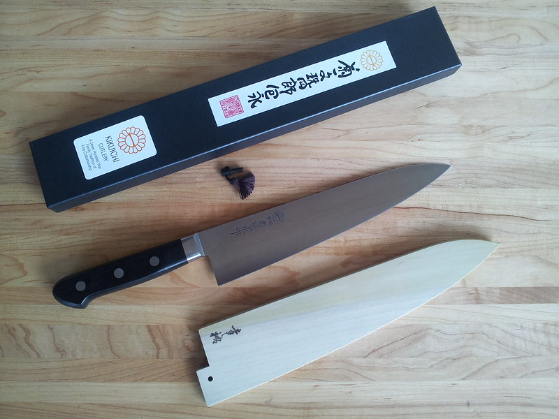

Will do, here's a photo, I'll post a separate thread after I get it dirty. :)
It's a beauty.
