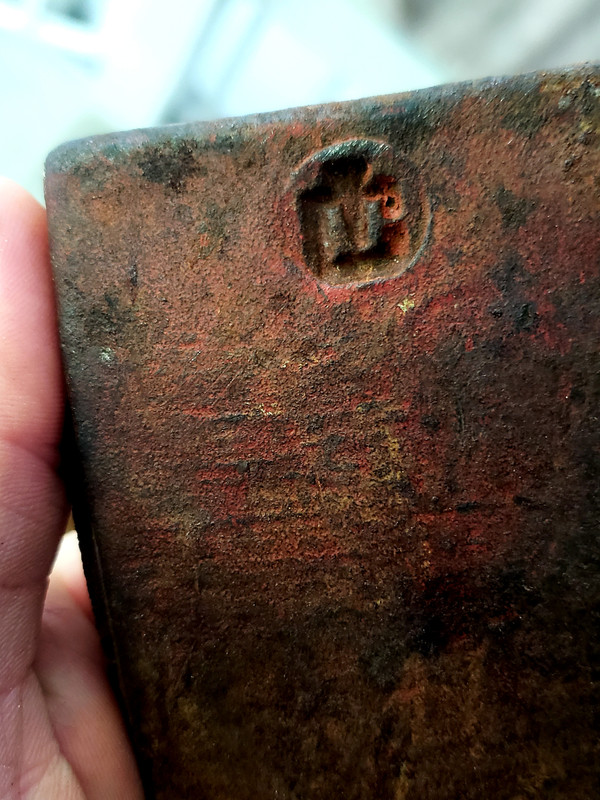

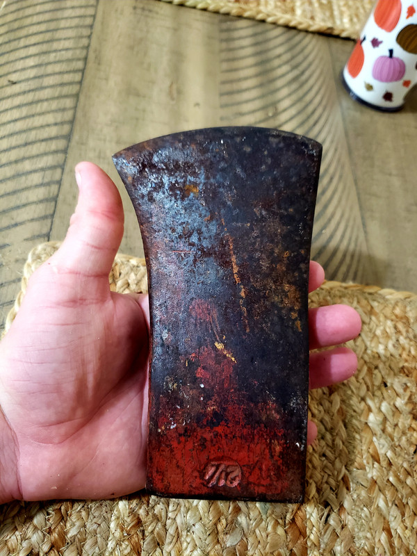

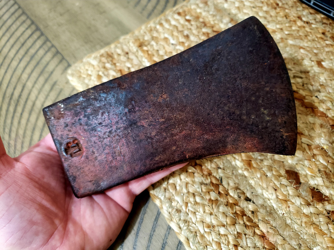

Hey guys, what do I have here? It had red paint. The mark is clear but it escapes me what the make is. Thank you!
Yes, made in USA. Nice full cheeks on that one. Great axe. Give it a half banana grind with some good hand files.
Yes, this is in good shape. Someone has left it outside by the dock for years. What is a banana grind?
I am excited to get this axe fixed up.
Here's a half banana. If an axe has convex cheeks, aka - a high centerline - then you grind back further in the center where the bit is thicker. The thickness of the cheeks will determine how far back you grind.
