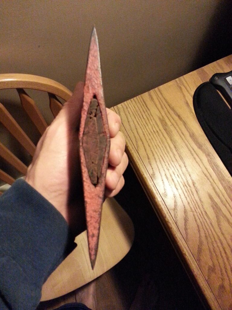

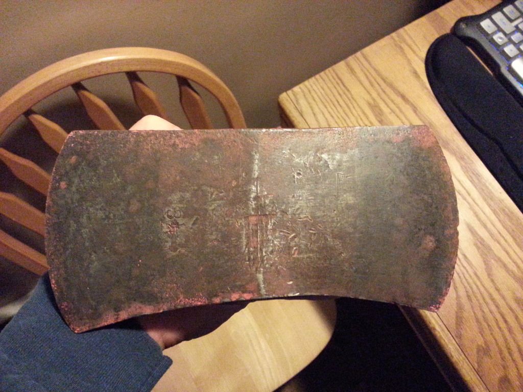

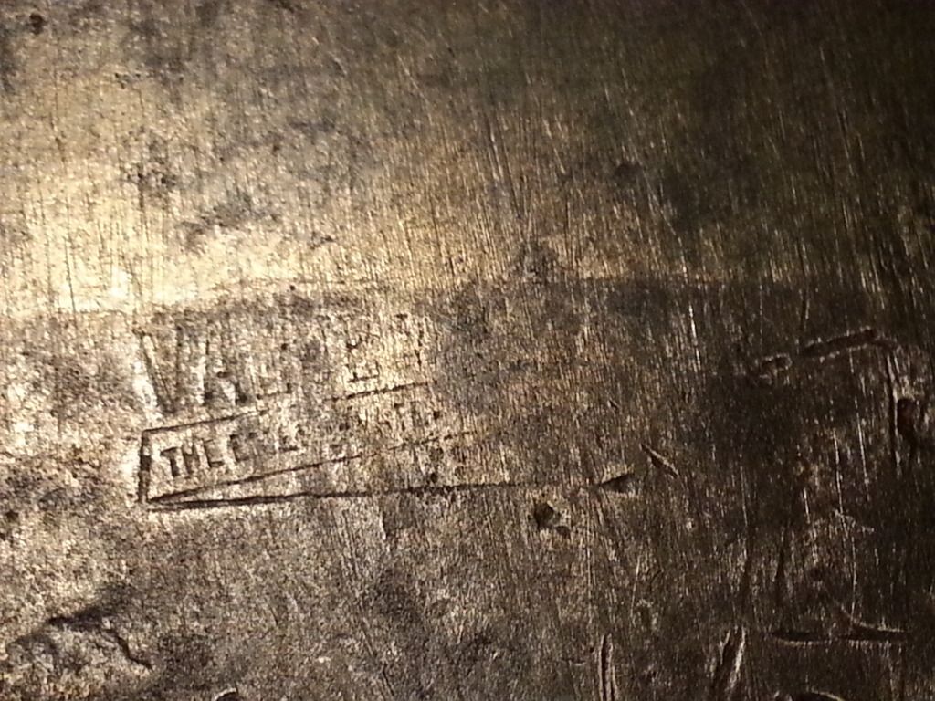

There have been some discussions about the way head weight is marked on domestic axes. We've somewhat established that the very common 3 2 stamp means 3 lb + two quarters. I'm curious as to what's stamped (illegible in the picture) under the 3 on the TBA head in post #10. I would presume it's a 4, as in 2 3/4 lb.
NE_OLDYANK_markings by city_ofthe_south, on Flickr
NE_OLDYANK_fit by city_ofthe_south, on FlickrIf we conclude that ES is indeed the manufacturer they marked them using a fraction.
Thank you sir! There is no disputing a picture such as that. So does that mean E & S also stamped 3 1/2 on their stuff instead of 3 2 like almost everybody else? Out of curiousity could the 2 digit stamp at the back of the head be year of manufacture?
All of the E&S heads that I have seen had the weight stamped using fractions.
