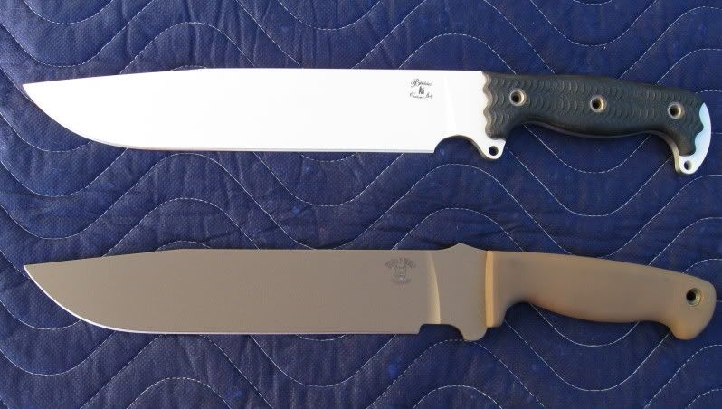

I've never seen that one, but it may not have lasted long enough to make it down to the range. I bought this Custom Shop SHBM in Arctic White at the Fall 2008 Knob Creek, so they must have finished a few leftover blanks:

These original blanks turn up as customs, one off's, ganza items, show specials etc. there were std, 1/300 blanks, and other blanks. Most of those are probably gone from the shop by 1-2 years ago due mainly to demand. you can age them depending on the handles and bolts/tubes. smooth and slotted are old and you are not likely to see those. Then look at brass tubes, typically that will be the 2002-2004-5ish time frame, steel tubes will be much later or that is how it appeared from what I got. At least that is how it appears, but I could be wrong with the time frame for steel tube transition. Handles, even if they are smooth will be much thicker in the modern made shbm's, and slimmer in the older ones. Not to hard to guess the age of one if you know what to look for.
documenting the variations, would drive you crazy...
just look at the handle variations in this pic
