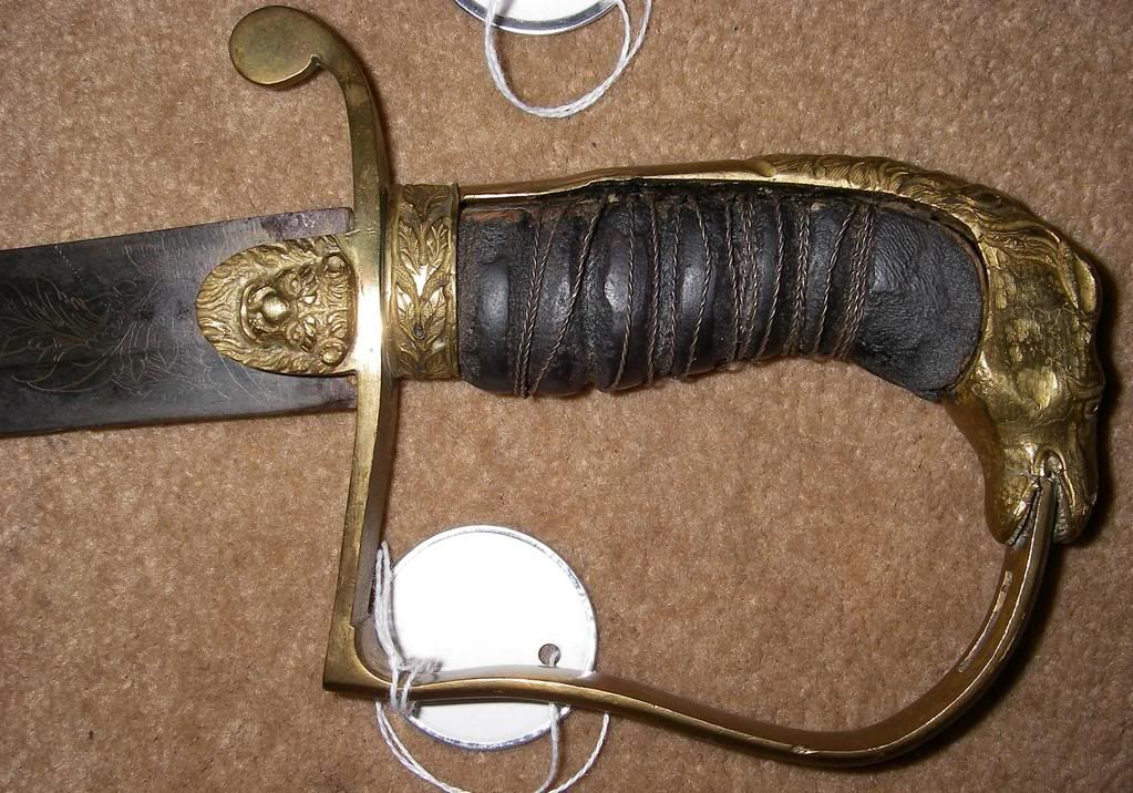

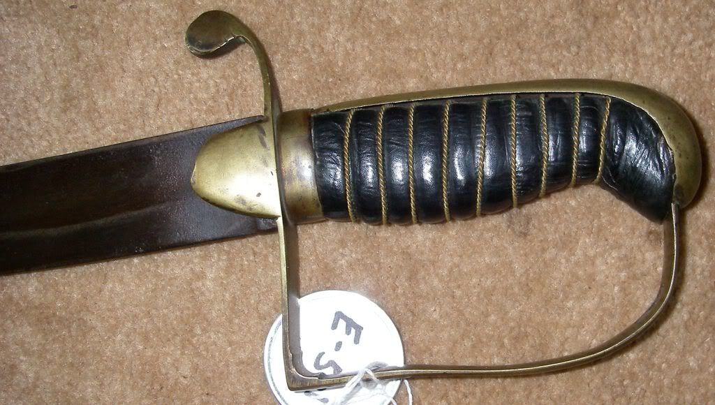

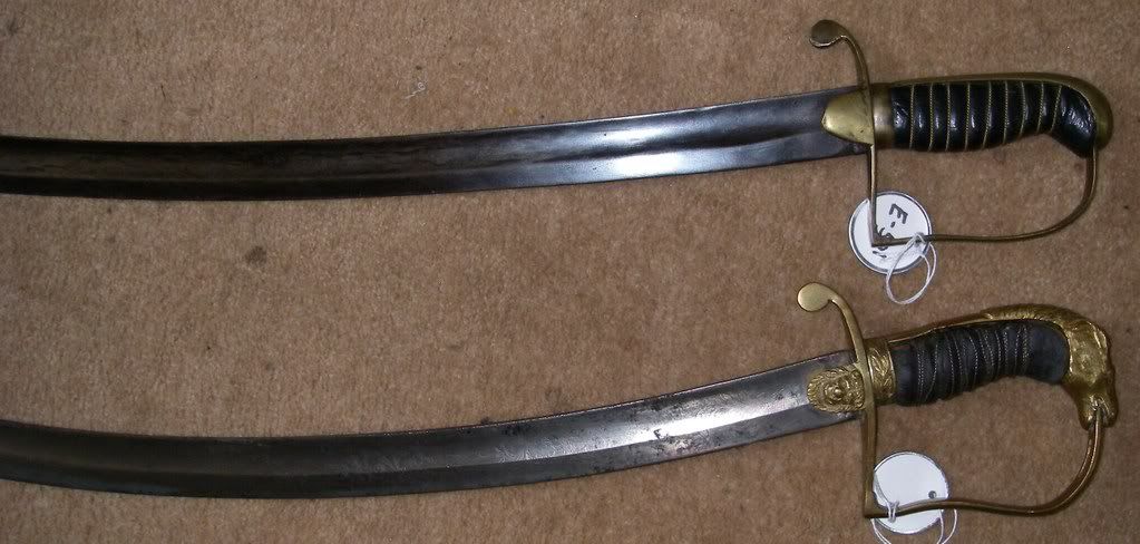

This pair of swords strike me as 19th Century Cavalry weapons...but that is about all we know. An "appraiser" listed the upper Horsehead sword as "Germany, circa 1880-1890". Does anybody recognize these as anything more specific? Dates/ origins? Many thanks!
To be honest, neither look like they were made for German consumption but both could have been made in Germany. You don't picture the entire blades, so length is tough to judge. I'm not inclined to agree with the late 19th century either but am sometimes as often wrong as right.
If the blades are less than about 32" but more than 29" (from guard to point in a straight line) I would be more inclined to say they were intended for American mounted artillery use from the first few decades of the 19th century. Still, very likely German made but also quite possibly British. Look closely at the base of the blades, up under those little ears/langets. Any marks at all on the spine of the blade as well. These grips both look like they were rewrapped at some point.
The style of the guards themselves says earlier than later to me. There were central and eastern European countries that hung onto them into the 20th century but the form is typically earlier. The reason I don't think they were made for German consumption is that we see the pronounced reverse P shaped knucklebows on their standard patterns.

Thank you, Horseclover! The blade of the horsehead is 27.5", while the plain sword has a 32".
The horsehead has some light etching on both sides of the blade, but I could not get a usable pic. No other markings can be found but I'll look them both over again.
These are from the estate of the late author Robert Jordan. The appraiser has been so terribly off on many of the identifications that I'm starting over on most items.
What I can see on the horsehead blade looks more like fine line engraving than etching. It also looks to have good hard gilding left on the hilt and I'm inclined to say this one is from Birmingham or London. Considering the blade length on that one, I would say it was for a light artillery officer. The plainer and longer blade is really quite typical for a mounted artillery blade from about 1810 to the 1830s. America imported bushels and bushels of them. Likely not later than the Mexican War period.

I just returned from the estate. No markings could be found on either sword. I did go back through his reference library and found 2 books by the aforementioned Richard Bezdek. Everything seems to indicate that these swords are both of European make for early American use. Neither, by the way, has a scabbard.
Be patient with registering over at the other site. Only one guy has the key to approve new regisrations and it can sometimes take a few days. Other times it can go through same day.
It is handy and not suprising that he would have had reference books for his collections. So many of the imported swords during that period are unmarked, it can sometimes lead to disallusionment but the plainer sword here is so like a geat many that it is pretty easy to categorize. The sword trade and cutlery efforts are really convoluted at times during the early 19th century that it is often only in finding an exact and marked match that a true source ID can be confirmed. Bezdek's 1812 title is helping me unwind some Philadelphia questions I have long had. There, as in Birmingham and Solingen, the numbers of folk involved and international trade really throw a lot of curves when looking at unmarked examples. if his library includes Harold Peterson's American Swords title, there is a more commonly found horsehead pommel artillery sword pictured in figure 97. I have seen another English made horsehead pommel with no American connection but do not have the images or reference on hand. It may just have been mention of such at the other place.
