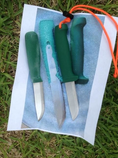

I can't speak directly to Condor, but assume it's probably the same poly pro used by most. I drastically reshaped the handle on my Hultafors GK and love it. The best tool for shaping was a sharp blade, after sawing the pommel and finger guard down. The material was easy to shave away, then sand. I then used a BBQ lighter to apply heat (gently, and after this pic) and it blends the small fuzzies back into the handle. Good luck and go slow.
